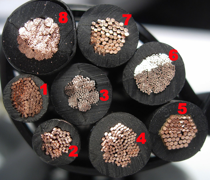

For a quickie overview I have the image below. It is the cables under scrutiny for the product comparison;
OEM Ducati
OEM Triumph
cheapie M900 replacement kit (knockoff of my original kit for the E900 circa 2003)
chain store 4 GA lead
small store specialty lead
marine grade bulk 4 GA ($5.69 per foot)
marine store 4 GA lead
and the HICAP 1000+ strand 4 GA
As you can see it is only the expensive marine store lead you buy in bulk that has any appreciable strand count and even then it is about 25% the stranding of the HICAP lead. The other wires are all thick conductor junk. The knockoff lead is barely the same size as the OEM and since it is tinned it has less flow than all copper.

Which one corrodes the least at the terminals, no 8 or what?
My experience is that that`s the main reason bad connection/starting w these cables.
Quality f sure helps but corrosion is the main culprit.
Just my 2c.
