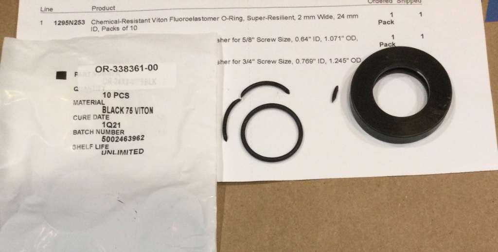

During my winter maintenance I found the steering head bearings had a lot of notchiness when going thru lock to lock of the bars.
Previous forum posts have been a great help, and I thought I’d post up some current info on what I’ve learned so far.
1st up is the replacement o-ring for the groove in the collar referred to as the “Distance Piece” in the parts manual.
I bought a pack of 10 from US industrial supplier McMaster-Carr, PN 1295N253
The cost was about $7.00 + shipping.

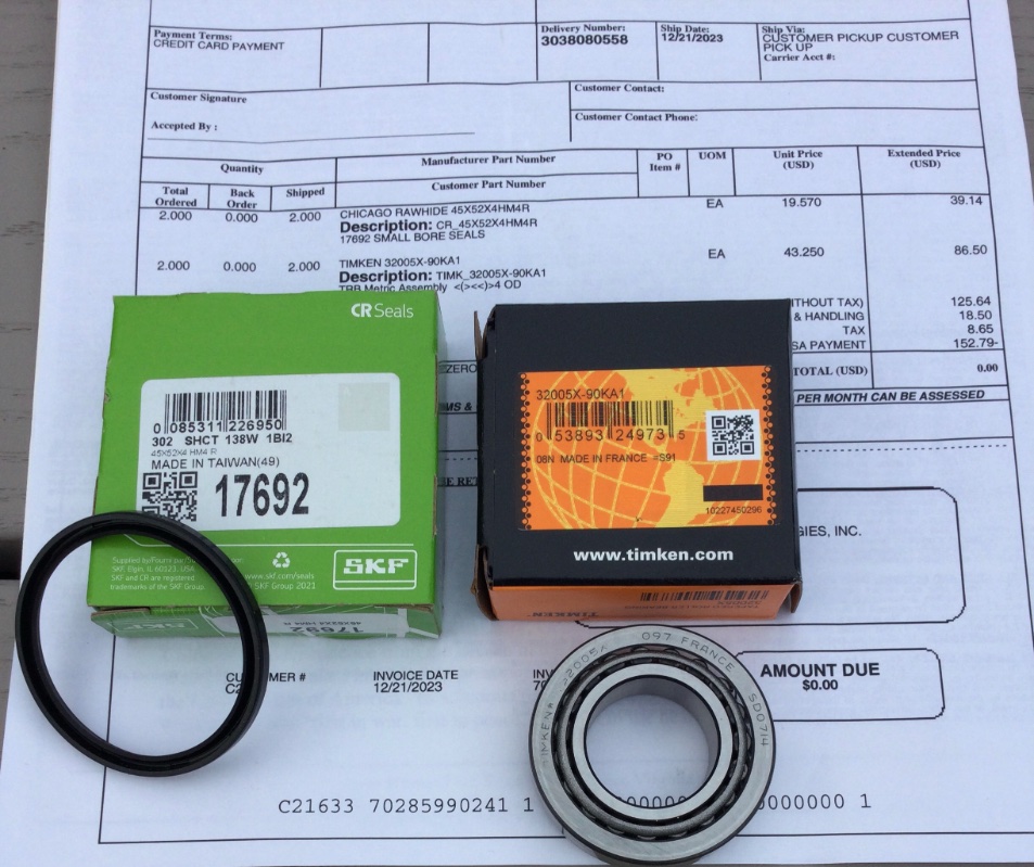

I ordered the bearings and seals from the supplier Applied Industrial Technologies. It took about a week for them to come in.
The attached picture has all the info, I’ll say bearing prices have gone up a lot. I was a walk up customer and I don’t have any connections to get a discount. But if you need them, ya gotta pay, and I’m ok with paying for quality parts.
