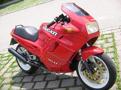

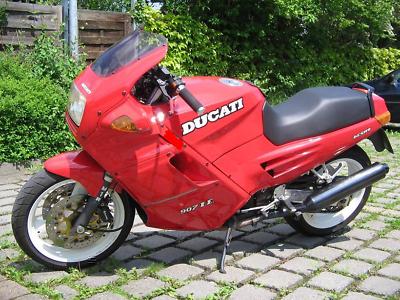

Here are the pics

welcome montreal69...nice bike to start with and although I wouldn't change the original upper fairing, diopa's alternative doesn't look too bad

I am from Austria, Tirol and wanted to buy this 907 ie two month ago. The seller did'nt tell that the bike was standing over 10 jears. He told me that the top part of the fairing was original from Ducati (optional). Your identification is right, it's a 1991 model with black brembos and black exhausts. I don't know why, but last week I bought a ST2 from the first owner. The ST2 has the further developed engine from the 907 ie. The Paso's and ST's are not popular, but they are milestones in the Ducati-History, I think.

Hello tognazi, it is not the same bike that you looked at. I just took the pictures because it is exactly the same bike i bought. Also the decals on the fork are the same. There must have been a dealer that has build up some with the diopa Fairing and they all look same. My bike is allready in pieces for restauration and i forgot to make pictures before.
I was wondering to see exactly the same bike with the same fairing and also with the same decals on the fork. Must have been a dealer special version.

But, I like very much that upper fairing, so if you would like to sell it to me or exchange it with the stock top fairing, let me know.montreal69 wrote:The only modification is an upper fairing from Diopa with a little tanned windscreen in it (I don´t like that).
