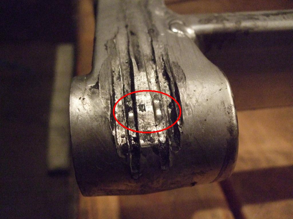

I just recognized, that i need a new swingarm for my 907 :-(
Has someone a spare?
I think mine is rubbish... You can already see the steel of the bearing shining through. :,(
This situation makes me very sad, and i hope someone can help me...

I gave it to the workshop for welding today. And it is a really good workshop: http://mmkiel.de/
They say it it is NOT easy to weld it, because the wear is so high, that the bearings have been worn, so there are real holes. They have to remove the needle bearings, weld it from the outside and rework the hole for the bearings from the inside.
It won`t be cheap, but i let the swingarm ther for repair... Next week i can get it.

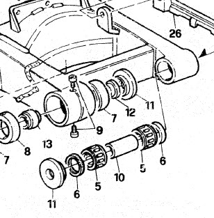

Another question.
In this picture, you can see steel shining through.
In the parts catalogue, i can`t find a bushing around the needle bearings.
Is it part of the swingarm?
Then i have to inform, the welding guys immediately...

Just met the welding guy.
He is nearly ready. :thumbup: The steel you see is part of the bearing.

Do you know why this damage happened?
Posts: 3378
Re: Rear Swingarm for 907 needed!
Looks like chain damage :wacko:

higgy wrote:Looks like chain damage :wacko:
Looks like the left lower side of the swingarm (chain drive side), slack chain??? :,( :,(
