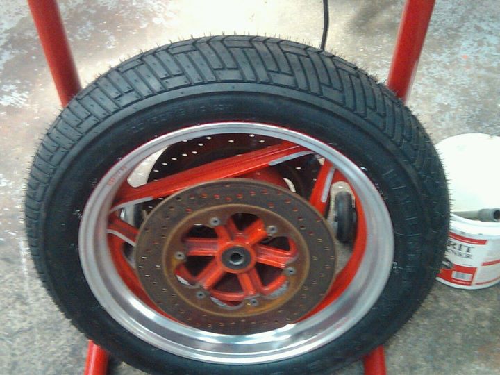

It seems i've caught some sort of bug after riding my mate's Guzzis (1100 Sport and Daytona 1000 RS) around the last few weeks.
Symptoms include:
- Moving my 750 Sport out of the bedroom.
- Ordering the closest set of matching tyres, suitable for the weight of the bike.*
- Removing the forks and shock and sending them to be freshened up (modern 20mm pistons with modulating shim stacks in the front, rear tba)
- Sorting longer air intakes, fuel line routing and electrical testing.
I'm thinking of removing the swingarm and giving to a friend of mine, an aluminium welder, to brace. Has anyone any experience with doing this?
*Tyres are lasertecs. 120/80-16 and 150/80-16. Front is fitted, no worries. Will have to raise the guard a little. Rear is on back order, eta 3 weeks.
