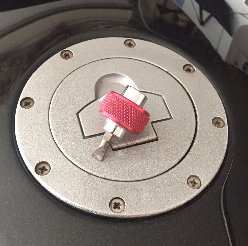

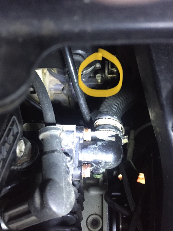

Opposite of what the OP had going on, my idle speed is a smige low to my liking, at 900-1000 rpm. It will occasionally stall, or just seems on the verge of it constantly. So I want to bump it up a hundred or two rpm.
So reading this post I thought I would give this adjustment screw a try. First was to locate the screw mentioned above, the picture was of some help. But left a lot to the imagination.
Here’s a better pic for others to reference. And I used this stubby straight bit driver: Or the 7 mm socket works too. So far the half turn I gave it hasn’t made much difference, but I ran out of daylight and it got too cold to make further adjustments and test rides.
I’ll report back after a full turn.

That is a great shot of the adjuster.
