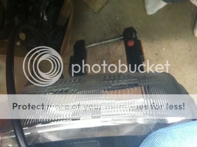

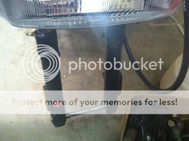

Thanks for all the help. I've been trying out some of the things mentioned in everyone's post. I measured from the rear wheel and I'm sure the right front axle centerline is forward of the left. I remember the first time I put the forks back in after having them straighten, the left side went right in (I had not loosen the top clamp bolt to the steering stem) but the right side didn't want to go, so I pushed it a little to make it go in. So i'm thinking the right side is the side that is tweaked.
My friend who is an airline mechanic and motorcycle mechanic/racer (in his younger years) says what you say about bending the bottom clamp. He said use my forks and we could bend the side . . . . and I said whoa. I just paid $110 to have the forks straighten (only one was bent according to the shop that did the work) so I was not interested in using MY fork to bend the bottom clamp. He said he had an old fork we could use. So that might be an option. I'm trying to get it ridable by the end of the month so my patients is wearing out.
How much do you want for the bottom clamp? I have another top clamp and some other pieces you might could use.
Below is some pictures. I have tried to show some reference points to show how far off things are. I think the pictures with the head light might exagerate things a little. The other pictures are the tubes and how far off they are when compared to the top clamp.
I'm confident that the fork tubes are straight. I bought a brand new axle, so good there.
Thanks eveyone

Yeah, that doesn't look right at all. Something is hinky up there.
Send me a pm with your address and I'll send you the bottom clamp. If it works, its $50. If it doesn't solve things, send it back.

Re: Forks are crooked after asembly
is that upper clamp right?
looks to me that has been modified somehow?
