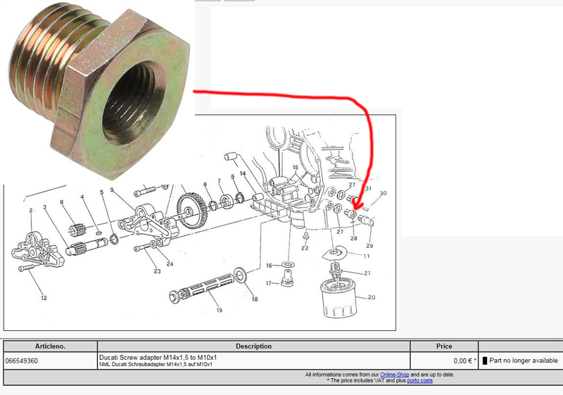

Part numbers are always useful... as I’m chasing one these myself. Pretty much any search for Ducati oil pressure switch is bringing back the M10 thread spec when the Paso’s are an M14 thread.
Anyone got a model I can use to narrow the search?
- Posts: 5571
Re: Oil Pressure Switch
They are not. There's an adapter.Pretty much any search for Ducati oil pressure switch is bringing back the M10 thread spec when the Paso’s are an M14 thread.

Thanks for the prompt reply, I think to make things easier in future the thread adapter is the way to go.
Found an adapter https://rover.ebay.com/rover/0/0/0?mpre ... 3696674173
here's another closer to the part in the diagram
https://www.fittings.space/gbm21-m14x15m-m10x10f
Also, while I'm waiting for the adapter to future-proof my engine, I found the Renault 25 uses compatible switch.
