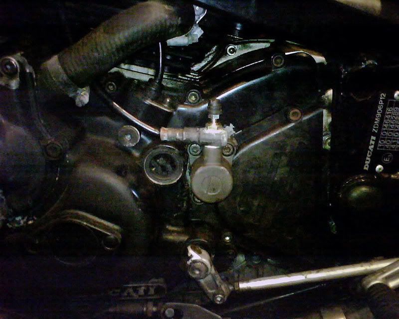

I was trying to bleed the clutch today, I saw two methods to do it online, and the second one started to work, but not that much pressure. (I accidentally opened it up when I replaced the stator)
Which one do you open when you bleed on the slave thing for the clutch? The larger one facing out or the smaller one with the rubber cap pointing up? I just tried the larger one and was going good, but after I filled the top reservoir up like 5 times it was just a little bit more pressure, so I tried to do it to the one with the rubber cap on the top and I turned it to hard, and it broke off, not the little bolt, the casing the bolt goes in...
What is a good cheaper replacement for the whole thing?
-Also, how much pressure should it feel like? Pretty tight or what, and will the pressure be the same as when the case is on and the engine is on?
Thanks

So if I understand correctly you tried to bleed the clutch and opened the bolt facing outwards ? That`s the banjo bolt that mounts the clutch line to the slave cylinder.
Why not check any service manual first ? They are all available here for download.
The bleeder screw is always the one with a rubber cap on. I wonder how strong you must tighten to crack the clutch cylinder housing with it.

The clutch is not connected to the alternator cover neither is it servo supported so it won`t make any difference if the engine is on or off or if the alternator cover removed.
The clutch is bled properly if you can disengage it without feeling any dragging or the bike pulling forward. The clutch lever should feel rather hard if you pull it.

sweet thanks. Do I need to replace the push rod if I get a new slave? (that sounds weird)
How do I bleed it? When I did it to the bolt on the clutch line I tried 2 methods I read online, (just the fast ways if I don't have a pump around).
-The first way I tried was pump the clutch. a few times, then hold, then open the bolt, then close the bolt, then release the clutch. That didn't work...
-The second way was to open the bolt, then press the clutch in , then close the bolt, then let go of the clutch, and that started to work a little?
Is the second way also the way to do it with the bleeder screw? And should the cap on the bleeder screw be open or closed while I do this?
Thanks again

hi,
with the second attempt your nearly there.
open the bleeder bolt, push in the clutch lever or brake lever, close the bleeder, relieve the lever and repeat the sequence.
good luck. ( If the brakes or clutch don't feel right, try again, don't ride, than you live longer)

Haa, that's what I'll probably have to do, I called all the places nearby and they said they only work on cars.
I tried to use metal epoxy to put it back on but it didn't work after 24 hours
http://www.ebay.com/itm/DUCATI-S2R-S4R- ... 57&vxp=mtr
-Is it possible that ones like this would work, or the one posted above, and the line going from the top instead of the layout of mine where it is facing the outside? (like the first link at stein-dinse)
Anyone tried one of these speed bleeders? http://www.ebay.com/itm/Ducati-Evoluzio ... 53&vxp=mtr

No you don`t. Not if you get one of the cylinders I listed above.Do I need to replace the push rod if I get a new slave? (that sounds weird)
I only mentioned the push rod length to say that all other clutch slave cylinders that I did not list can`t be used on a 907ie and these are exactly all the ones you`re looking at !
All the ones you list are post model year 2000. These bikes use a longer, 33,2cm push rod. In case the push rod is compatible you could use one of these clutch slave cylinders if you`d swap the push rod, too but I have no experience doing that.
Some aftermarket clutch slaver cylinders come with a tiny adapter/spacer (shown in the middle of this pic). W/o the spacer you can use the clutch slave cylinder on newer bikes and with on older ones with a shorter push rod.
You can ignore that your clutch slave cylinder has the clutch line attached to the side. The 907ie and the early 851 were the only Duc models with that. All others had the clutch line connected to the top via a banjo bolt with integrated bleed nipple. (just like in the photo you posted)
I did post the link to an ebay auction with a part that should fit.
btw
Let me guess you tried that with everything in place meaning you did not drain the clutch fluid, remove, clean and dry the housing before you attempted to fix it. Did you mix the epoxy ?I tried to use metal epoxy to put it back on but it didn't work after 24 hours
