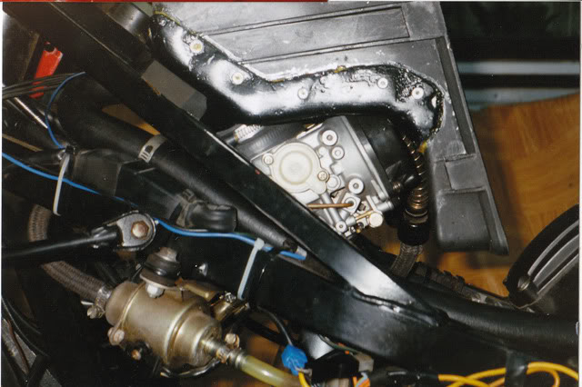

I've been around lurking just reading up, ( I have a Ducati 750 p ) with 4k original miles, I want to do the mikuni swap. Anyone have any pictures around showing how the carbs look once installed?

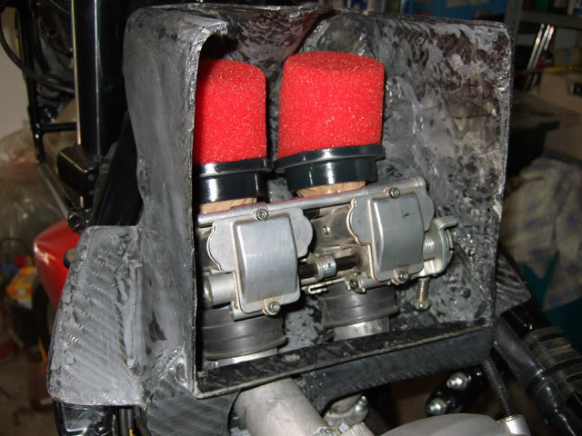

Great, that you so much . Really gives me an idea of how much room I'm going to have for air filters, any suggestion on what I should use. On the old Weber I had the low profile k & n set-up, but obviously that won't work. Maybe a couple of the ball type foam uni filters?

Back to the topic: there're many post about mikuni swapping and air filtrer solution, including mod to the original airbox, longer mainfolds and anything else. Just need to make your own search

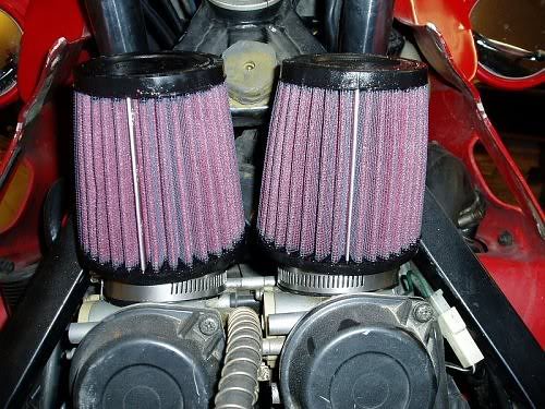

you can use UNI filters UP4060A (angled pods, 10cm high)
or the UNI filter UP6060A (same but 15cm high). I`d take these if you have no airbox.
These are K&N SN-2530, once posted on the forum
Or you can modify the original airbox
