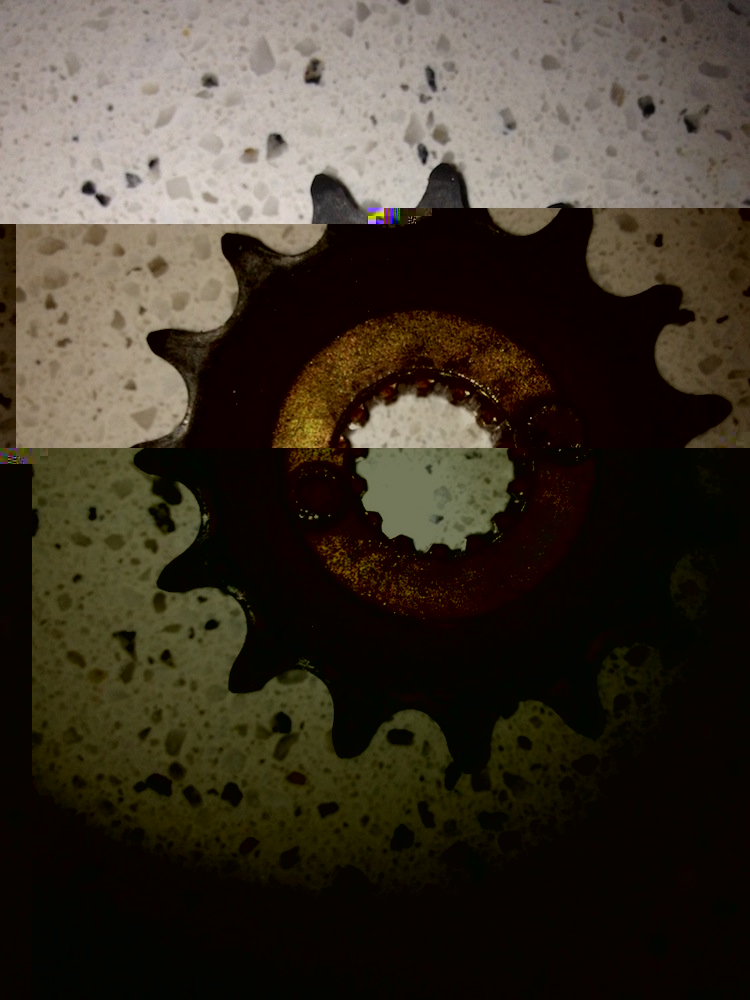

Took the old girl (750 sport) out for a spin today with my young nephew on the back, got 200m up the road when the bike lost drive from the main drive shaft, found the front sprocket (see photo attached) on the road about 50m away but nothing else, the sprocket looks okay, the splines dont seem to extend all the way from the front to the back, seems to be missing about 10mm of splines from the outer part of the sprocket, the splines closest to the engine look okay. There is a threaded hole in the middle of the drive shaft, its dirty and does'nt look like its had a screw in there for a while.
My question is this, does anyone have a photo of the front drive sprocket in situ so that i can tell what mine is supposed to look like, my parts manual seems to have 2 types of sprockets, none of which look like mine.
Secondly is there is supposed to be some sort of plate on the end of the drive shaft to hold the sprocket in place, if so i wonder if i could just make one up out of a heavy washer with a new bolt ?

Re: 750 sport dropped the primary drive sprocket
Looks to me like the retaining ring is knackered .... lost its splines , and the whole plot just fell of the end of the shaft
..... AND you have the same kitchen bench top as me
The retaining ring ( different to yours as this is a 906 and the sprocket is on the other way round ) should have splines in its center which locate in a groove round the end of the shaft . When the retainer ring is fitted you slip it on to the shaft and then rotate it ( 1/2 a spline ) slightly in the groove and fit the cap screws , this stops the sprocket falling off . In your case there is no bolt fitted to the hole in the end of the shaft

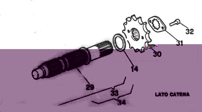

this is your setup
I hope you still have that washer behind the sprocket as according to the parts catalogue it comes in three different sizes.
No Paso 750 i could'nt find part no 14 and as for part no 31 mine is round rather than oval, but how hard can it be to find a washer that size ?
that washer is od 36mm, id 25,3mm, thickness 0,8 or 1 or 1,2mm.
The question is what is that washer for and what defines the necessary thickness ?
Many Thanks Hamish and Paso 750, you were spot on Hamish, i have stripped the outer ring, wow thats one to check on your bikes guys, never thought that might happen. Guess i'll have to buy the sprocket and ring as they probably come as a pair, as for the washer maybe its set into the engine casing rather than floating free on the shaft, if i have lost it i should be able to buy all 3 you mentioned Paso 750 from the bolt shop and try them all till i find the one that fits.
- 907pasonut
- Posts: 604
my 907 doesn't have that washer (14) and I can't think what it could be for, as the sprocket retainer (31) keeps the sprocket in place...

- Posts: 2000
No , I have another still in the packet
I cant figure out what that washer does either , unless the 750s sprocket is only 1/4 inch thick in which case that washer might act as a packer so that the sprocket doesn't wiggle about to much on the shaft , the paso sprocket being 1/2 inch odd thick ( with that extra shoulder width ) would be less wiggly.... maybe
I'm beginning to think that the schematic might be a bit misleading, i cant see any need for a washer there either, it also doesnt show the bearing and seal that sits in the gearbox housing behind the sprocket, maybe the washer in the schematic is actualy inside the gearbox behind the bearing and seal ?.

- Posts: 5570
I agree some schematics can be misleading but in this case I doubt it because the washer that`s on the inner side on the drive shaft is shown in the parts catalogue as well. It might be this one sits on the outer side behind the oil seal but why would it come in different thicknesses of 2mm increments ?!
That shim is shown in all parts catalogues from P750, 906, 907ie etc.
I guess the easiest would be to ask a Ducati mechanic. Someone who rebuilds Duc engines will know.
As far as I understand now (from the Haynes manual) that shim is still inside the engine case and with the one which is on the other end of the gearbox makes sure the gearbox sits centered. So it`s not relevant in this case. Sorry if I caused any confusion with that.
