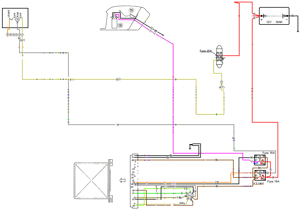

The fuel pump only gets power when the Kill Switch is in the on position. Remove the RHS side cover, and at the back of the tank is a 4 pin plug and socket. This is where the power for the fuel pump goes through to get to the pump, and the connection for the fuel gauge. Unplug the Plug/Socket and use a Multimeter to probe the 4 connections until you pick up 12 volts (assuming the kill switch is in "Run"). It should be the violet wire if it is visible. If you find 12 volts, turn the kill switch to off and see if it disappears. If all good, then the issue is between the the plug and the tank (ie: wires, connections etc). If no 12 volts, then most likely the wiring to the relay or the relay is shot. Out of curiosity, do the 2 relays (up near the regulator, LHS behind fairing) have fuses incorporated in them? It may just be a blown fuse (or 2)?
There is colour schematic in the documents which will help.

The other possibility is you have no ground. The circuit is grounded by the ecm which has a diode that is easily repaired. So if you find both relays do have power but you still have no fuel pump you will need to replace the diode assuming all the wiring and relays check out OK

Well I did some more fault finding today and as suggested checked the plug that fits onto the pigtail from the tank and did not get any power going to the violent wire, only the blue wire showed any power going to it.
also checked the prongs where the relays plug in and only had power on one and believe that was no. 30.
This bike is a 91 and my other two are 93's and they will not turn the eng. over with kill switch off but the 91 will turn the eng over in off or on. Guess I will pull the relay receptacle off and start testing that. Any other suggestions? Thanks for the help, Arch.

If you have power to one you must have power to the other, its a short wire jumps between the two and very unlikely to be the problem. Could possible be the relay which most often is the fuse part of these kind of relays, but you already said you switched the relays so.............
sounds like you have no ground on the fuel pump relay which means you need to trace the ground back to the ecm
my money is on a popped diode at the ecu ground which is a simple thing to verify. Just ground the wire at the ecu connecter, if the pump runs the diode is blown in which case you have 2 choices. Put the fuel pump ecu ground wire on a switch to ground or solder in a new diode in the ecu

the blue wire you mentioned goes to the fuel sensor so that´s irrelevant.
Contact #30 on the relays is the main feed which is connected directly to the battery (see diagram above)
Did you check if all fuses are ok and if you get 12V on the grey wire connecting to one of the relays (when the kill switch is in RUN position and the ignition switch is turned to ON) ?
One relay switches on the Marelli Digiplex unit which then activates the second relay powering the fuel pump which means that when the ignition is turned ON (kill switch on RUN of course) you should measure also 12V on the white wire going to contact 85. (the upper relay in the diagram above)
If there is it can only be a ground connection problem as higgy says. (unless the relay itself has gone south but you can test that)
