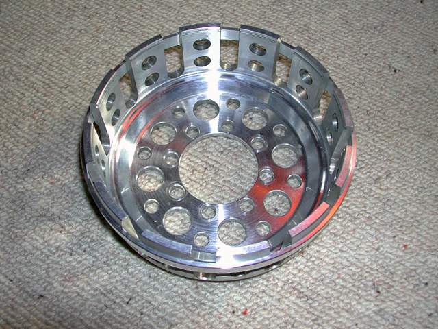

I do have a brandnew alloy clutch basket. A beautiful & lightweight piece I bought from an italian guy who had made a miniseries.

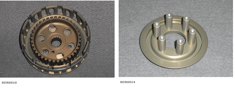

as for the basket, drum and pressure plate, I managed to find the following:
- OLD RACING PARTS
8DR0010 – F1 L.S. S.M. Montjuik Dry clutch kit = 463,60 Euro
8DR0014 - Pressure clutch plate light = 195,20 Euro

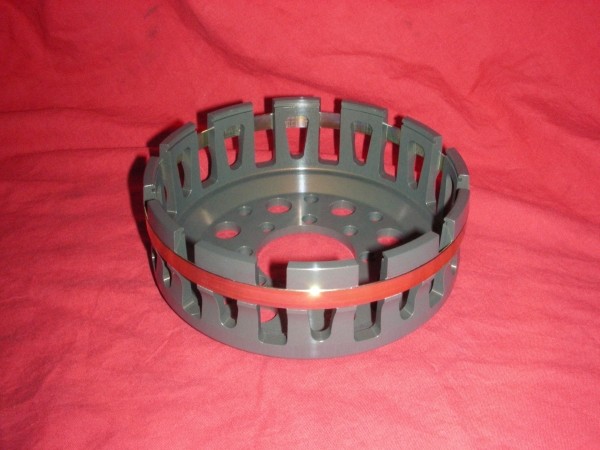

Then I checked with Ducati Kämna and they told me they have the Basket, beautifully made, (at 231 euros), but NO other parts.

- Frizione OLDRACINGPARTS.jpg (100.38 KiB) Viewed 12183 times

- Frizione Kaemna.jpg (55.77 KiB) Viewed 12183 times

are the first two pics also Kaemna parts ?

G., the first two pictures are from Old Racing Parts in Italy, the second is from Ducati Dortmund Development and the third is from Ducati Kämna

As for the rest, I did notice the milling on the drum (internal where mates fith the shaft) is different looking at the Kaemna and the Old Racing Parts.
It should be like in the Kaemna picture, I guess the other is just for catalog purposes as the finer milling is typical of the later engines.

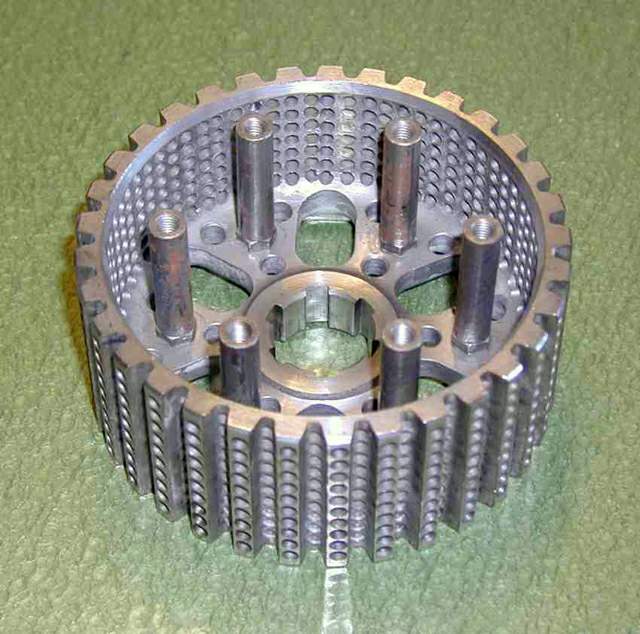

If you have too much time you can do what this guy did
Alloy basket and drums will require alloy clutch discs or you`ll have chatter marks pretty fast.
- kkern.jpg (62.45 KiB) Viewed 12140 times
Re: Paso clutch (again) compatibility / aftermarket alternat
that is sick!!!!
nice work tho'

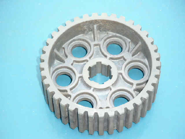

I had a reply form Ed, he advises not to use the alloy drums/hubs as they tend to crack.
I have the feeling a lot depends omn how they are made, I guess a that using forged 7075 alloy (ergal) would be better than the casted version (looks like) I found.
Wow , Ed replied to you, I'll be buggered !
On a serious note, that is a coarse spline clutch hub ,that will NOT fit the paso or later models, only
the pantah's and 750 f1's , you need a fine spline for the sports and paso's.
If your motor has a coarse spline input shaft , it is either a early 750f1 or a 650 pantah motor.
if it is neither of these then you will have the short input shaft,that will not fit a dry clutch assy.
I am not sure if it is a fine or coarse spline, my engine is a mix of a half dozen different models, unfortunately I really do not recall the spline type and despite having a million pictures the ones I have of the cranckshaft show the spline taped for "protection"jayh wrote:Wow , Ed replied to you, I'll be buggered !![]()

The F1 clutch cover has a larger diameter bore than the paso for the piston,hence it requires more fluid from the master cylinder to operate.
I was warned that people have had trouble with incorrect clutch activation,by not using the matching master cyld.
I'm not sure on that as I wont be able to test mine for a while longer,but if you do have trouble,this could be a reason.I don't usually operate on heresay but Ian is very knowledgeable on ducati's,so I thought that I would pass the information along.
The later model 750f1's have a fine spline input,the same as a paso.
The earlier 750f1 ,650 pantah and allazura motors run a coarse spline input.
There is also a coarse spline wet clutch input shaft that looks the same but is 4 or 5mm shorter and cannot accept a dry clutch modification.
Jay, thanks for the input, however I need to clarify few points just to avoid confusion.jayh wrote:The F1 clutch cover has a larger diameter bore than the paso for the piston,hence it requires more fluid from the master cylinder to operate.
I'm not sure on that as I wont be able to test mine for a while longer,but if you do have trouble,this could be a reason. I don't usually operate on heresay but Ian is very knowledgeable on ducati's,so I thought that I would pass the information along.
rgds jay
I went through my files and yes there was an F1 cluch cover with a bigger slave piston, however I cannot be sure that it was fitted to all the models... knowing ducati that was only on few selected such as the Laguna Seca or the Montujich, unfortunately without having access to all the literature that is not possible for me to confirm.
Anyway, when I mentioned I had a F1 racing cover It was because everybody seems to identify the one with the OEM "racing" drilling as being from an F1.
The same cover was fitted to other models (without drillings), however Ducati also supplied it DRILLED as original spare part and had the very same slave piston as the one you find on a standard cover, in fact I got the spare from the local duke dealer and that is exactly the same as the old one.
My dry hybrid clutch (999 MC, standard slave) works perfectly fine... the whole point of the excercise was because I just wanted to see if , out there, you can still find anything racing related in case someone wants to have something lighter.
My case is a little particular because my engine is unique as it is assembled with parts coming from Paso, Elefant, M600, M620, S750, SS750, F1 and only God knows what else...
as nothing is standard, you understand that in my case applying standard rules it is nearly futile
one example is the spline clutch side... I truly do not remember how is it the one I have so, to find it out, I will have to phisically look into it; unfortunately the engine # is irrelevant as I dont know exactly what crankshaft I have
It does not matter anyways, from what I am told, the best thing to do is to keep the original steel drum/hub as it appears the alloy version tends to shatter under stress.
