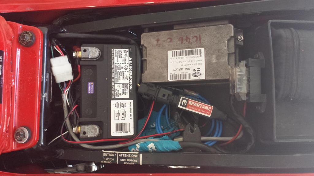

Going down the path of wide band O2 sensors was not quite as simple but still straightforward. I chose to use a Spartan 2 by 14point7 http://www.14point7.com/products/sparta ... ntroller-2 . These are pretty good value (AU$220) and compared to some of the competitive wide band products using the latest Bosch sensor the features I liked about the Spartan 2 unit are the fact that they unit is compact and that the long cable tail is easily trimmed to length on a bike (not pre-terminated with custom plugs on the ends of unnecessary cable length) and also it is self calibrating so that provided you follow the instructions it’s plug and play. It also includes a bung to weld to your exhaust.

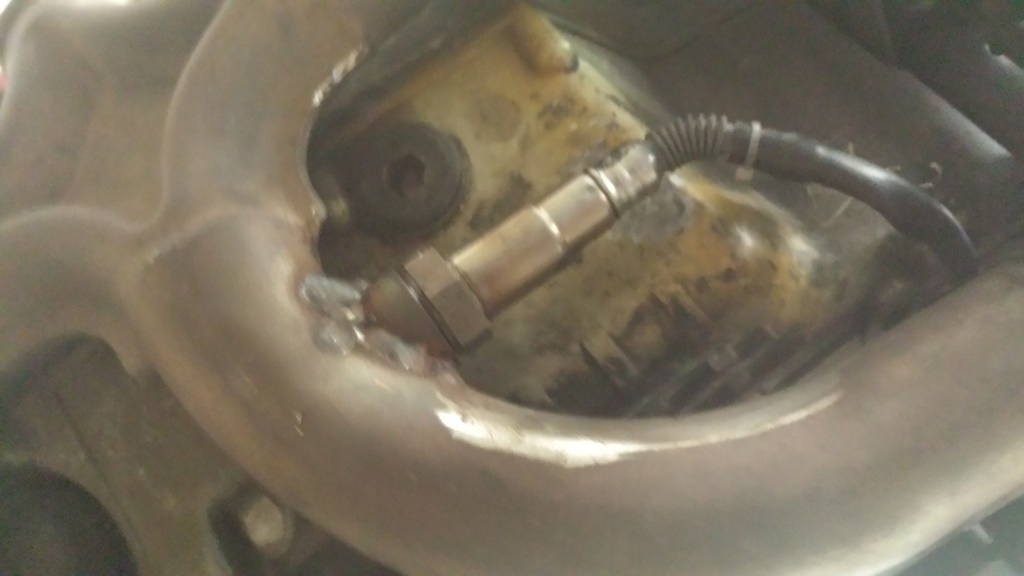

My O2 sensor was fitted after my exhaust collector on the inside right hand curve of the exhaust pipe under the engine. It’s a compromise position balancing distance from head (away from too much heat), distance from the end of the muffler (a source of oxygen that might cause misreading on the sensor), aesthetics (you can’t see it unless you get under the bike) but still retains the preferred amount of “drainage” tilt. Getting this welded in at the local exhaust shop was about $40.
