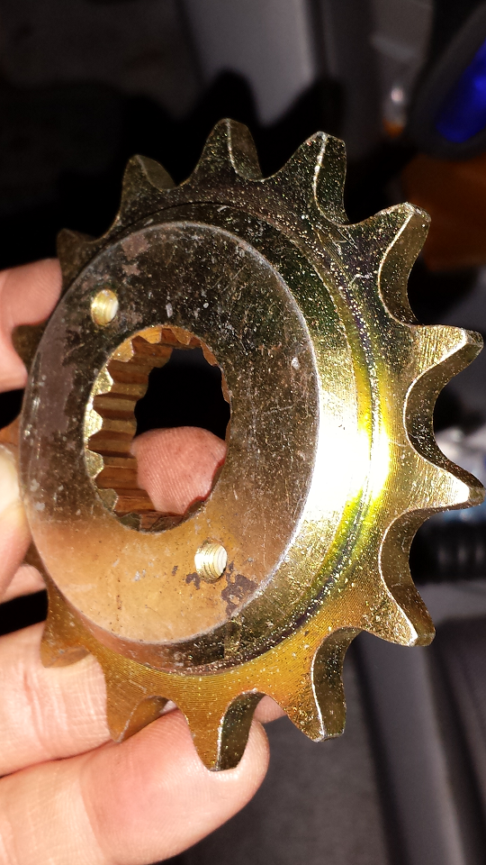

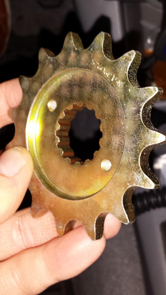

I got this front sprocket and it's not the same as my old one which is totally gone. Notably, it's got a shoulder on one side and is dished on the other. The old sprocket is flat on one side and shoulder on the other.
I can't tell if the old one (I just bought the bike) is stock, as the sprockets are each SEVERELY warn on opposite sides, so it was obviously cross chained. Just curios if anyone recognizes this sprocket. It also has a much narrower grip or spline depth, so less of the sprocket contacts the spline and it would likely wear faster.
Thanks fellahs -Dave

That sprocket is for a 750 Paso not the Sport.
If your drive shaft has the fine splines the sprocket is the same for the SS, Monster, 851, 888
If you have the large spline driveshaft you`ll need a deep dished sprocket - just take a look at the parts catalogue.

Thanks P750. I'll get the right one. Cheers

Which year Sport? The early ones didn't have the spacer on the right hand side of the engine between the frame, so they needed a bit more offset. That sprocket might be correct. Later models shifted the engine to the left by a bit, to get a better chain line. Your best bet with a Sport, is to get a laser pointer, square up the wheel in the swing arm, and use the laser to determine which is the correct sprocket to use. Which part number is the sprocket you have in your hand? I might need one of those some day? That looks about what I ended up with mine, but I went a completely different route to get there.
