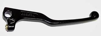

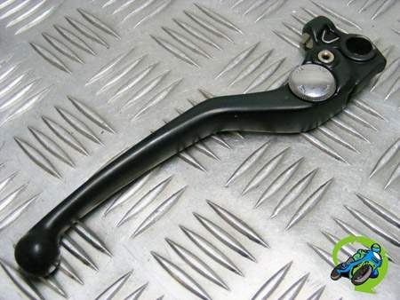

The adjustment screw on my levers is rusted permanently in and I can barely reach my levers. Are there any adjustable ones available? It's not really clear on the Pazzo or CRG websites. Cheers -D

there are for sure ways to loosen that rust.
However there are many different types of Brembo brake & clutch levers and there are adjustable ones that fit also on a Paso/Sport. These if I`m not mistaken were used on the 748/916, early 900ss, Monster and different Guzzis & Laverdas. These are bikes with Brembo PS master cylinders. The levers for the Brembo PSC mcs are different.
