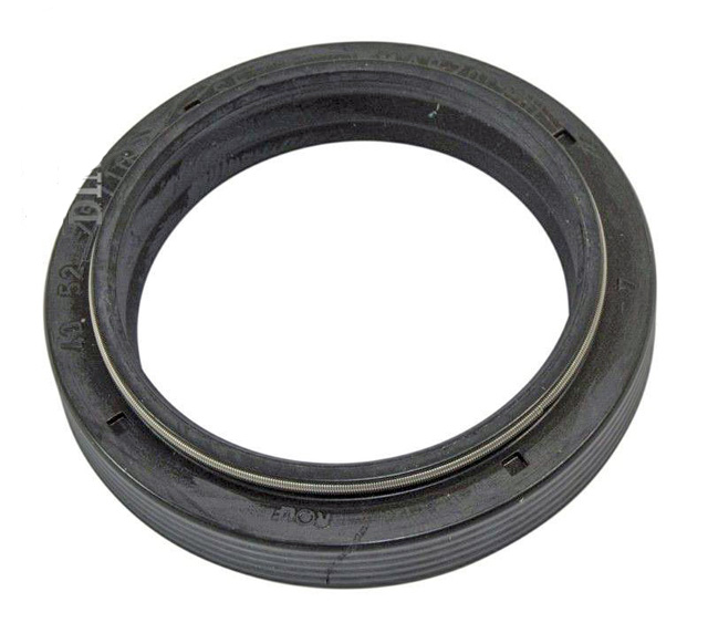

actually those are not the correct size but often sold as such.
This is the original one
- 93040081a.jpg (98.05 KiB) Viewed 19257 times
Re: Marzocchi M1BB seal, bush & dust cap Kit - where do you
Peter, I`m in doubt that a 0,5mm height difference changes it all
The original one is 7,5mm. Does the 10mm heigh one fit without any problems ? For the Paso many shops also sell seals that are slightly higher than the original ones as replacement. If one then tries to fit them it`s really hard to get the stop ring into its groove which is why I`m asking.
Hi G,
That is an interesting observation.
The 10's or 10.5's are what I pulled out of mine the first time they went (maybe it was a Tuesday bike, hey Angelo lets throw these in just to confuse them later Muwahahahaha
) and given it's age and being in storage for years, and what I was doing to the poor old dear wasn't at all surprised when the originals started leaking (wish I had taken a photo of the sizing molded on them)
Keeping in mind I have no reason to doubt they were the factory fitted seals (1990) and the bike had 5200 Km on it when it was bought, when I fitted the 2nd set of new seals (10.5) they were a nice snug fit under the retaining ring, and had no issues fitting them whatsoever, have changed out a lot forks seals on various bikes (42 bikes in 38 years of riding/racing) and these style of forks have nothing to them design wise to be overly concerned with, seemed very straight forward to me, so maybe a bit more practiced at it?.
I believe the gap with the 9.5's allowed some form of movement under braking at the track days, but you never know.
Both seals were leaking at the end of that day, so that's my one and only theory, they were seated nicely, there was was no stiction, and the forks were working nicely all around the track, otherwise no idea why two brand seals would start leaking after one day of hard use, other than they where generics bought in a hurry for a ride day, there is absolutely no pitting on the Stanchions, they are like new and even so still went other them with 0000 steel wool to make sure of no dags, bumps, lumps and so on when I had them apart.
'Pose this answer will just confuse everyone even more than usual
Peter
