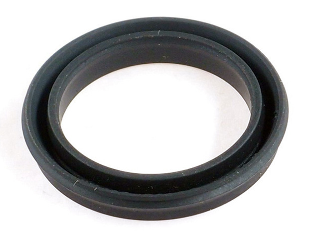

93040091A is a V shaped seal and imo already better than the old o-ring. I think I`d prefer that to a square ring.
- 93040091A.jpg (90.13 KiB) Viewed 14896 times
