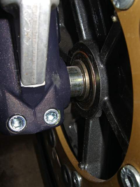

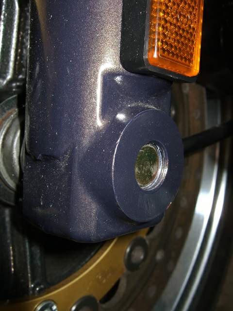

I was wrong with this of course. I remembered the gap between the rim and fork leg narrow and this washer being a spacer between both which it isn`t. I should`ve checked on the bike before.I don`t think the right fork leg floats into alignment. I guess the washer makes sure its alignment is correct.
The washer shifts the axle to the right so there`s only one reason for it I could think of which would be that the thread on the axle is too short to tightly bolt the wheel to the left fork leg hence that the end of the axle thread hits the slider tube too early. You`d have to remove the wheel, fully screw in the axle until its tight and then compare how much it protrudes on the outside. If it`s more than with the wheel in place there`s no reason for the washer. If it`s about the same the washer might make sense.
on my P750
- DSCF9696.JPG (32.8 KiB) Viewed 10387 times
- DSCF9698.JPG (36.54 KiB) Viewed 10387 times

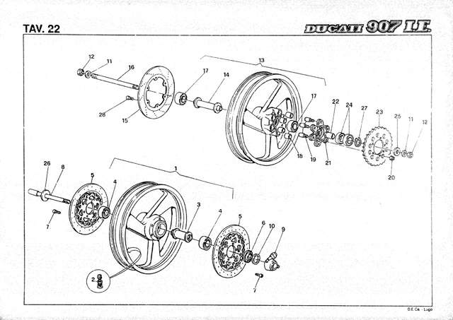

Re: Oddities
better late than never

from which parts catalogue is that ?
- 907ie_parts_catalog_Seite_47.jpg (36.12 KiB) Viewed 10380 times
Re: Oddities
edited from the manual
- Posts: 5570
Re: Oddities
Why one shows the washer and the other doesn`t will remain a mistery.
(but then sometimes the same pictures were used in different wsms i.e. 900SS or parts catalogues so you can`t always rely on them)
