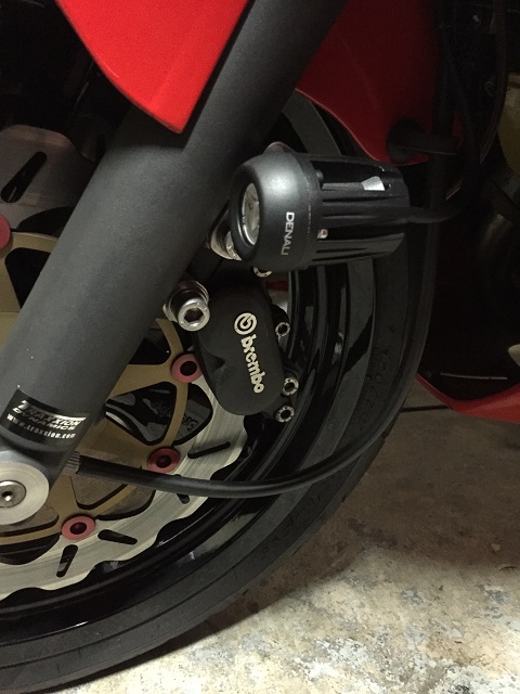

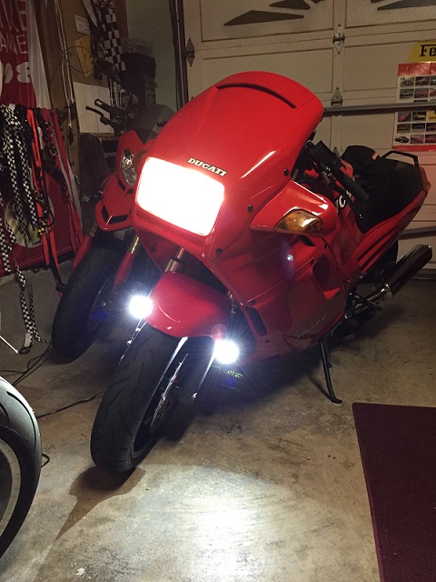

Drivers of cars just do not see motorcycles. I usually put an extra brake light at the bottom of my rear license plate and some driving litghts at the front to help with the safety.
For the front I went with the Micro SD Denali lights and they are mounted at the upper bolt of the brake caliper. The wire hugs the brake line, so it looks fairly unobtrusive.
