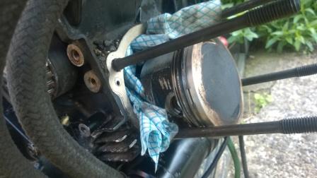

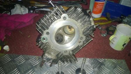

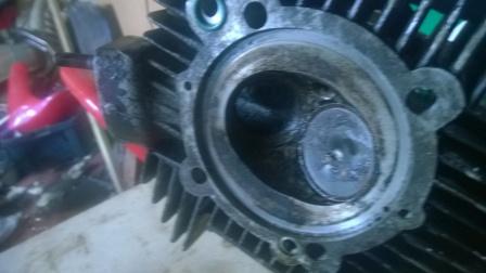

Just a bit of an update and another question ... when the front barrel was taken off the top of the piston all but wiped clean however if you look at the side shot on the indented part of the piston its black ? easily scratched ...can only think its over-spray from when perhaps the previous owner threw paint around ? ... the front and back of the piston are clean,the rings free and no obvious blow by exists in places I would think usual ....
The picture of the head shows how grim things are .... have now cleaned the valve up and the section where it was originally ground in has appeared through the crud .... the seat itself looks ok ... Wondering if valve wasn't closing properly or not being closed ... so a re-shim is in order .
Other than that had a good look round the brake hoses look to have been new just prior to me getting the bike ... no flex at all when the the lever is pulled but I will as a minimum change the fluid .
Should have the gaskets and belts arrive next day or so ...then the fun starts ! And the pestering will go up a gear or three !

that`s carbon build up/oil crud. Quite typical on engines that run rich or have ignition problems or are just run occassionally or ridden mostly short distances (w/o load)however if you look at the side shot on the indented part of the piston its black ? easily scratched ...can only think its over-spray from when perhaps the previous owner threw paint around ?
You had the bike stored 7-8 years and I guess you`ve ridden it for a while before that so the brake lines probably are 10+ years old. Even if they look good and don`t need to be replaced now I`d get steel braided brake lines sometime in the future.Other than that had a good look round the brake hoses look to have been new just prior to me getting the bike ...
Do the clutch basket or core have chatter marks. That could make clutch operation hard. Also was the pressure plate removed and the pin on its backside checked? There was a topic a while ago where this pin was either broken or stuck. Can`t remember ...

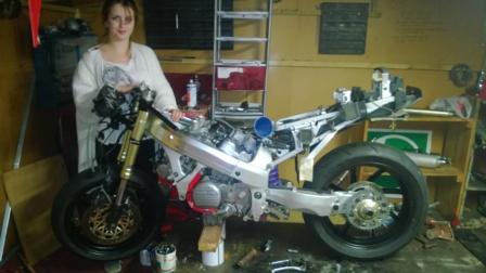

Still Bloody Waiting For Parts !
Engine wise things have ground to a halt .. I've had parts,mainly gaskets and seals, on order from a Ducati dealership for getting on for 10 days ... still waiting !
Also found out today just how many Torx bolts this seems to have ,most frustrating was that having packed up a tool box with what I thought would be okay ... I then realised I couldn't take either the top yoke off or worse still get the front wheel out ... should add bikes at a friends house ... So attention turned to the rear caliper ... Took the pads out which looked new and made sure both pistons were working .. what I did find tho that one pad slid easily in and out whilst the other was quite tight .... Had a bit more of a look and realised the disc itself was slightly offset to the center line of the calipers .... Looks tho thin spacers should sit between the caliper and the hanger ? Checked the parts book which doesn't seem to show any but have to say not that fond of the old Ducati parts books ... I worked in a previous life as a Parts Manger for VW/Audi so can nprmally find myself around that sort of thing .... this is much more fun .
Only other thing we found was one of the pad retaining pins had lost its wire collet ..which we've now sorted .
So tomorrow its front wheel out and calipers off ... give them a look over then back on with new lines ..
All and any thoughts welcomed ...pics to follow
Dale/Jaz
Dale/Jaz
