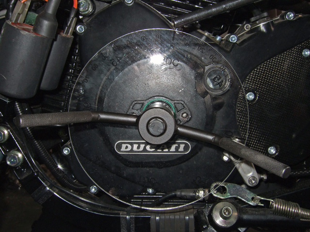

Replacing the belts is straight forward. Rotate the engine until the marks on the cam pulleys and the driving (bottom) pulley align with the marks on the engine.
I added my own marks on pulleys and belts so I could copy them on the new belts and be 100% sure the new belts would sit exactly as the old ones without skipping one tooth by mistake. If the belts are going to be reinstalled also mark the cylinder and the running direction.

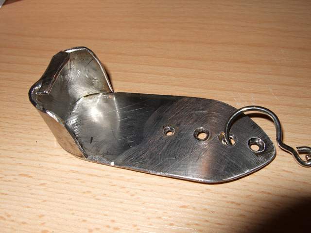

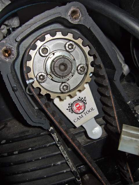

I bought myself a cheap tool to lock the cam pulley of the rear cylinder. What some don`t know (although it should be obvious) is that all marks that were aligned before mean the front piston is in TDC. The rear piston of course is not. In fact a valve rocker spring is putting pressure on the camshaft rotating it counterclockwise a bit as soon as the belt is removed. (hence the tool which is just stuck with double sided tape) Of course one can just be careful and make sure the pulley mark is aligned again when the belt is installed.

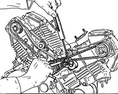

On our models Ducati used a tensioning tool which was nothing than a spring balance, later there was a more sophisticated tensioning tool and nowadays it`s done by setting a specific resonance frequency.
The first tensioning tool just had a mark on it. According to the SS/Monster Haynes manual the tension would correspond to 4.5kg (10lbs). A german Monster manual would say it corresponds to 1.5-1.8kg...?! (what is it?)
Just out of curiosity I figured I`d just try if setting the tension with a spring balance was possible at all and made a small bracket to fit on the belt tensioner pulley so it`s surface wouldn`t be scratched. The pulley of the horizontal cylinder would have to be pulled upwards which is already a bit tricky lacking space and the rear cylinder pulley would have to be pulled to the rear which is impossible with the engine in the frame so I scrapped this method.

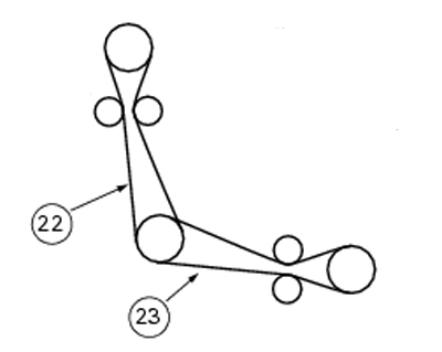

The official Monster 696 service manual shows were the measurements should be taken. (Measuring between fixed pulley and cam pulley is definitely wrong while measuring between the driving pulley and the fixed pulleys gets about the same results +/- 1 or 2Hz. In fact the vertical cylinder is measured between the driving and fix pulley, while the horizontal is between driving and tensioner pulley)

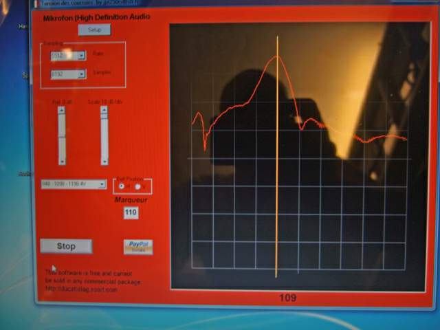

There are numerous programs that can be used from spectrum analyzing software to programs used to tune guitars. Nice are programs that have a peak hold function meaning that the loudest frequency reading will be shown on the screen also after you`ve plucked the belt.
Via the italian site http://www.desmodromico.com I found a french software tool which can be downloaded here http://jpdiag.akress.com/ . It`s the last file called "Courroies".
This software was specially programmed for tensioning Ducati belts.
It`s very simple. No settings need to be modified. The program seems to contain the old frequency specs so select a model that has a 110Hz tension setting (i.e. 848/1098) or just change the "Marquer" setting by hand to 110. The red line in the graphic indicates that setting.
When the current frequency is measured a yellow line will indicate the peak. On the bottom the program will also show the measured frequency. Then change the position of the belt tensioner pulley until the yellow line is on the red line. 104,5-115,5Hz is the range you should be in. (110Hz +/-5%)

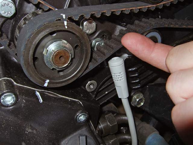

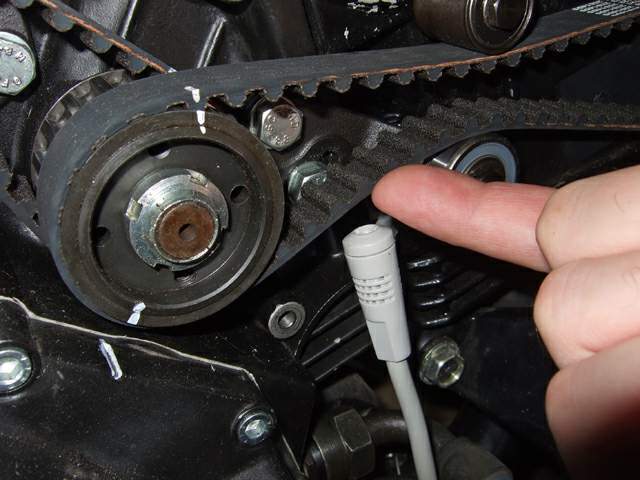

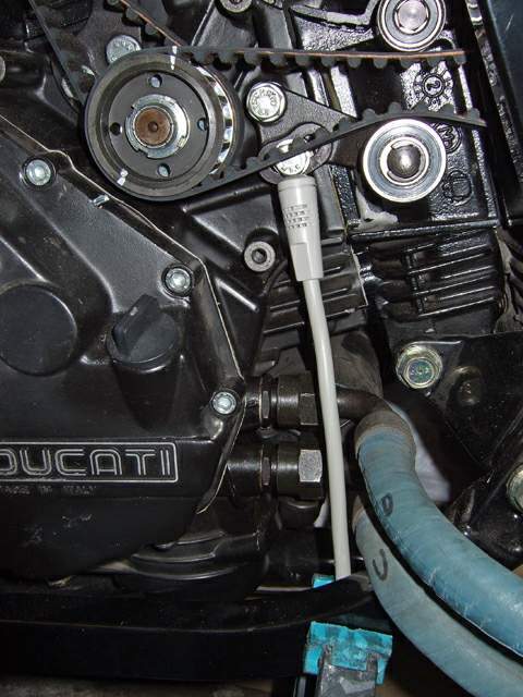

The microphone is positioned about 1cm (0,5") from the belt. Ideally if it`s one with a long neck like mine it doesn`t touch the frame unless at the point it`s mounted to as this might influence the reading.
This job is ideally done in a closed and silent garage as every car driving by or a dog barking two houses down the road will show in the graphics and the yellow line might be jumpy.

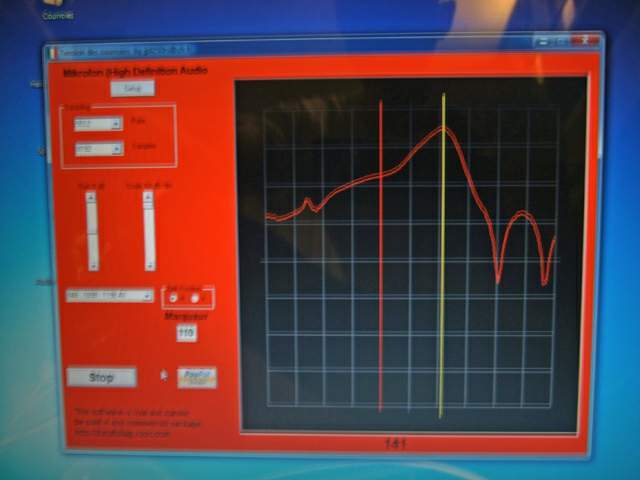

Click "Start" on the program and pluck the belt in the middle of both pulleys. If done with the thumb while keeping the hand on the engine the peak reading will be the same but there are more disturbing moises registered. Pluck "normally" without force.
There`s no "peak hold" funtion in the program so you need to look at the screen while doing this. It may take a few attempts until you get a steady reading. Plucking the belt in short intervals will help.
My first reading was 141Hz, hence too tight

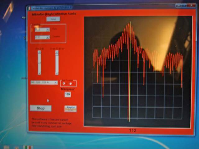

There are two bolts on the belt tensioner. One is the rotating axle (the easily accessible bolt) and the other the locking bolt which is partly covered by the belt. Undo both a little bit so the belt tensioner can be moved as required. Handtighten the tensioner and leave the locking bolt loose. (If you`d try to get to it you would have to move the belt out of the way and this might move the tensioner). Then try again.
Must have been beginners luck as it varied between 109 and 112Hz which is perfect.
If that is correct tighten the tensioner pulley to spec (P750: 20-24Nm/14,5-18,1lb/ft). (Note that this might move the tensioner outwards/ away from the belt minimally which will decrease the belt tension so recheck tension). After that the pulley locking bolt can be tightened. The frequency measurement should be repeated and again after the engine was turned over by hand a few times.

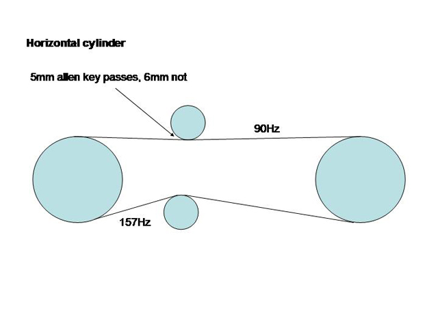

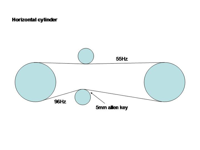

Setting the new belt to 110Hz (measured at the point shown in the Monster696 wsm) actually gets to that result. The frequency measured between the fixed (the upper one) and the cam pulley is about half which I had about expected. This section of the belt is about twice as long. If it was set to 110Hz here the belt would be tensioned way too much which imho proves that taking a reading here is plain wrong.

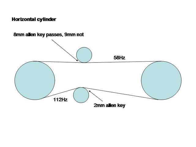

Using the allen key method which describes that a 5mm allen key should still pass between the belt and the tensioner pulley results in a tension which is too low for a new belt but ok for a used one.
The allen key method which says a 5mm allen key should pass between the fixed pulley and the belt but a 6mm not results in a tension that is too high. Looking at the old obsolete tension specs it is within the limits for a 996 which makes me wonder if this method originally came from the 4V fraction.
It says here http://home.comcast.net/~mmullen38/Beltadjust.html that at warm engine the belt tension increases by 7-8% (on a ST4). If that is similar on other engines the belt tension resulting by this method at cold engine already exceeds the tension of the first method with hot engine.
These are my findings. Results may vary (as I only did the horizontal cylinder so far and didn`t remeasure after turning over the engine yet but I don`t expect the results to vary that much).

Hail to the inventor of transparent timing discs with black printing :banghead:
