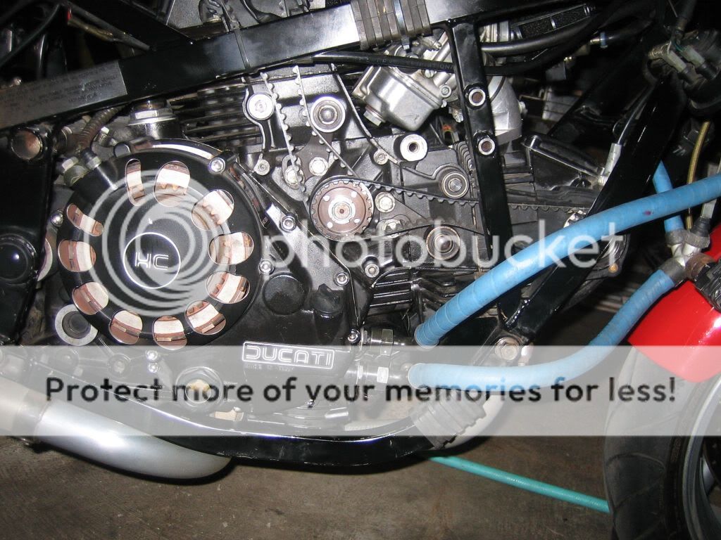

Thank you for the reply! I've reread the FAQ and I'll probably take screen shots of all the good info and pictures and head west to Munroe Motors/SF. Kieth, parts wizard at the shop (rides a mint Darmah) will be able to help me source what I need from a 91-97 900SS with his access to the linked inventory of the west coast Duc dealers. I will take my Nichols ventilated clutch cover off and take the measurements of the existing slave's piston and have a close look at the assembly. I'll get what parts I can obtain together and bring them and the Paso sans bodywork on down to Nichol's shop in Union City for their expertise in reassembly, possible machining of mushroom pin and bleeding the system. Thanks to everyone for the info and documentation on this subject. The forum is such a blessing! I'll report my progress.

Thank you both very much. Good news and great information! I am fairly certain my Paso has a clutch cover from an F1. Again, I am so grateful for all the time, energy and comradeship that makes this forum a continual bright spot in my life as a Pasoist.

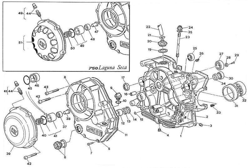

Is that good news?! Have you tried to find a F1 slave cylinder?
What`s the diameter, did you remove it and if so could you post pictures?
According to the F1 parts catalogues there were three clutch slave pistons.
067516450 31mm diameter and no o-ring groove as that's in the cylinder (part not available anymore) #41
067016460 31mm diameter with o-ring groove (part not available anymore) #46
066516450 28mm no o-ring groove (Laguna Seca/same as on 85 Alazzurra 650) #49
I really hope your slave piston is not the big one.

I guess I spoke too soon, w/o a real understanding of the situation: I haven't been able to devote any time to disassembly just yet. I've too busy trying to find work and make a living. I'll get at it this afternoon and report back here a.s.a.p. Thank you for your help and your time! That certainly looks like my clutch cover...

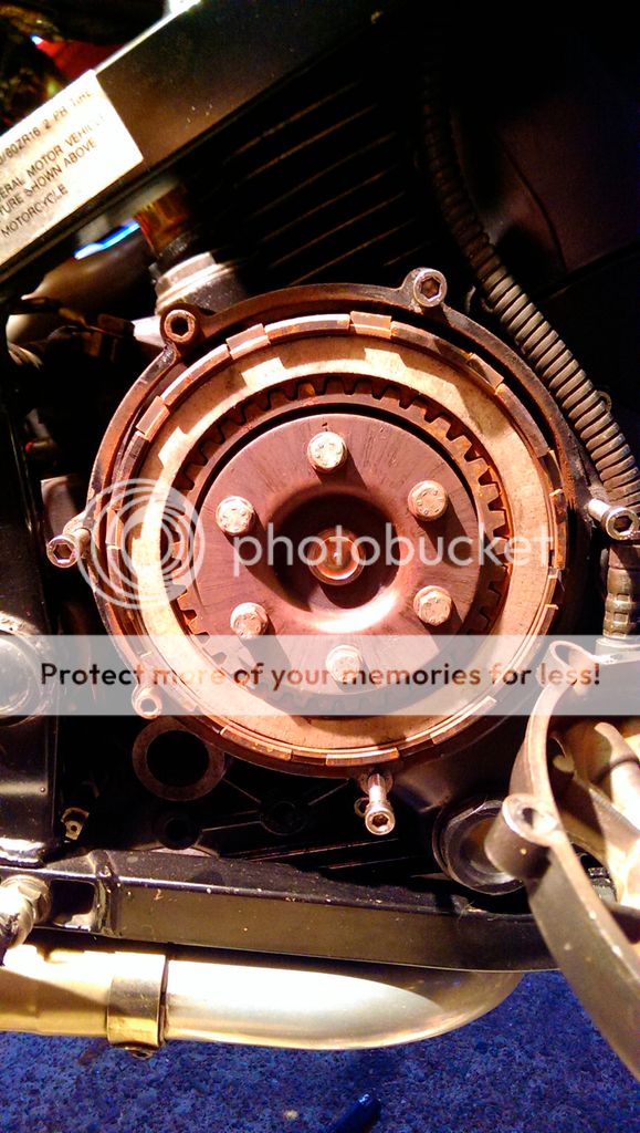

26mm diameter piston, ventilated Paso clutch cover by Nichols. Piston,bearing sleeve and mushroom pin all stuck together (#46, #37, #36 on Table 10 of the parts catalog). Any suggestions on how to get them apart? I am such a novice that I don't really understand what failed. Perhaps because they are the parts are somewhat fused together? There was no loss of clutch fluid before I drained the system to remove the piston. Thank you all for the kindly assistance. Thanks and praises!

Hamish is right. What makes me wonder is how dry and clean the clutch cover and also the newspaper on the floor is after removing the piston. Where`s the fluid?
Clean the piston and check if the bearing runs freely and makes no scratching noise. The pressure pin still looks ok. If you want to remove it pull it out gently. It can be stuck due to oxidation or be held in place by the little air that can get inside the piston (like when pulling the plunger of a syringe while holding the tip closed). Check if the recess in the center of the pin is actually a clogged hole. If it`s not you can try to drill through the pin with a fine drill. Trapped air won`t be holding it back then and you can also spray some WD40 in it.
If the bearing scratches or is seized check if the cylinder wall in the cover is clean, has scratch marks or traces of black rubber. A seized bearing can cause the piston to rotate consuming the o-ring.
If the bearing is shot you can try to remove it but that`s quite difficult w/o damaging the piston.
