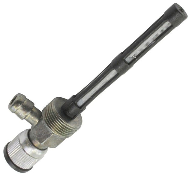

There was a tiny amount of flaky corrosion resting on top of the petcock that I cleaned out. After cleaning, petcock ran gas thru no problem, but I do not know how to get to filter in the petcock?

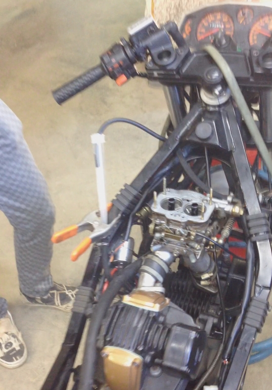

Photo of test setup: turkey baster feeds new fuel filter; fuel filter to "Y"; "Y" to carb, and return line to turkey baster. Gas manually fed into turkey baster as it was used.

If you removed the fuel petcock from the tank you should have seen the filter. This is how it looks (it`s not the identical one but similar).
If there was a jet in the old Y piece it might have been stuck inside the old fuel line. I can`t tell how important that is. Might not be bad that there isn`t one as the fuel pressure of the standard pump is too high for the Weber anyway.

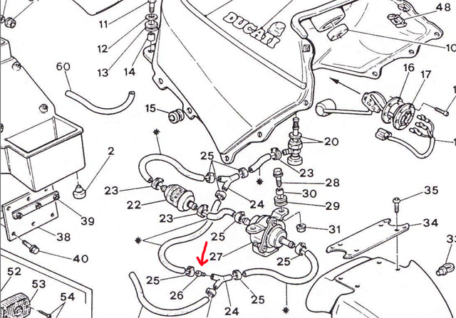

and the jet was not installed by the factory. It originated here and a few other forums
Re: Observations and a question (or three)
wrong
- Unbenannt-1.jpg (131.27 KiB) Viewed 91597 times
- Unbenannt-2.jpg (24.3 KiB) Viewed 91597 times
double Y ? never saw that one before
