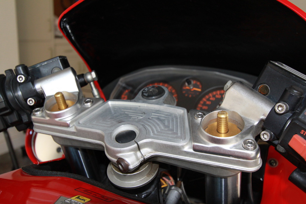

don't know anything about who did this to my m1r fork - I got it this way. Seems to work well enough, tho... Can't say the same about the rear suspension. Its a weird Fournales? air shock. Really harsh rebound, but I don't have a clue how to adjust it
