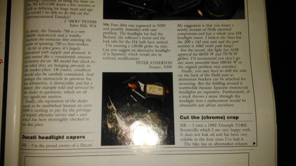

How is this for a memory!
Way back when the 750S was all the rage I found a feedback letter to a Motorcycle magazine asking what was suitable replacement for the headlight on a 750S, as the Ducati unit was super $$$. The magazine response was to fit a Hella replacement. The part number was Hella 1043. Google this and you get a lamp size of 200mm * 142mm. I think the 900SS used the same headlamp?
This a 30 year old memory, and even I don't trust it that much, so I will try and dig out the magazine and check it.
Cheers.
Nick.
Cheers.
Nick.

nickta
- Posts: 305
Re: UK Spec headlight
Hi G.paso750 wrote:were`re missing the smiley with the dropping jaw. Nick you still remember a part number mentioned in a 30 year old magazine and also think you still can find it?
I sometmes wish I could instantly remember what I had for lunch the day before...
Hella vs original
Well it does appear the porridge in my head isn't that accurate.
Found the letter to the bike doctor, but it was referencing the Paso headlight?
In defence of the steel trap (my mind), the Bike Doctor did own a 750S at the time, so there was more than a little extrapolating going on.
The Hella 1043 is way too small to be a Paso headlight anyway.
But I did get the part number right
Cheers.
Nick.

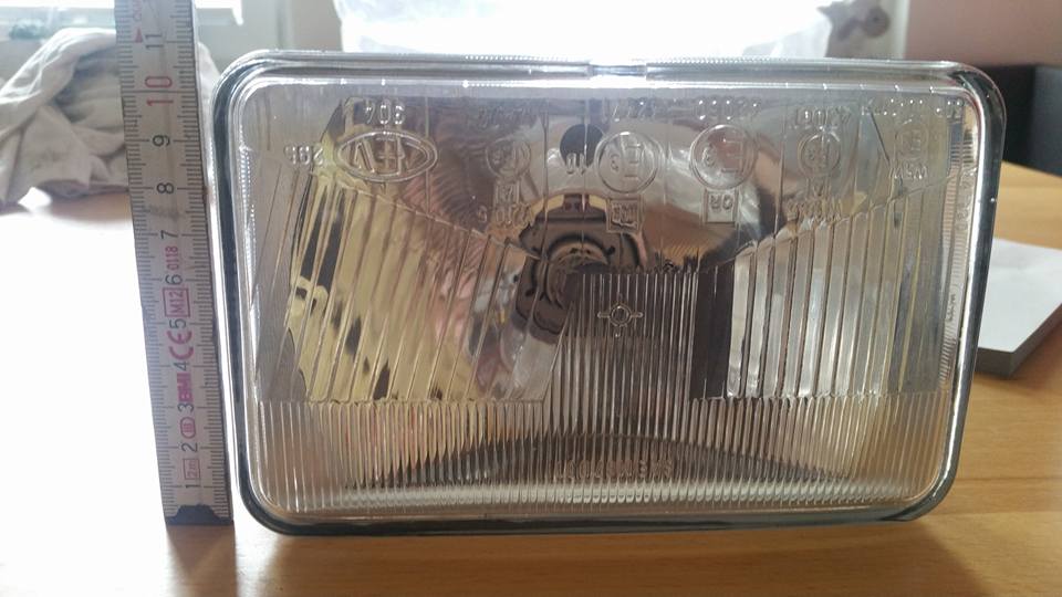

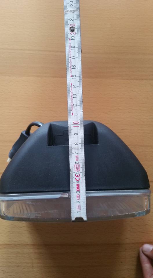

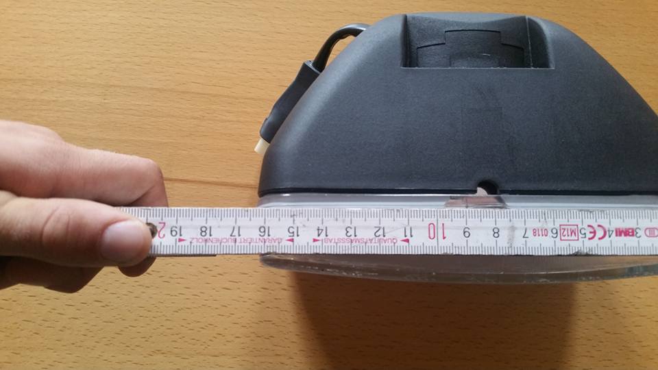

who can check the dimensions of the headlight lens and overall depth of the headlight?
the glass of the TZR headlight is 16x10cm

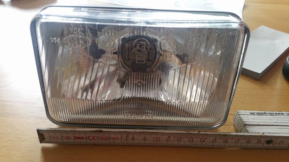

a guy on the Paso FB group was so nice to check the 750S headlight dimensions (165x105mm)

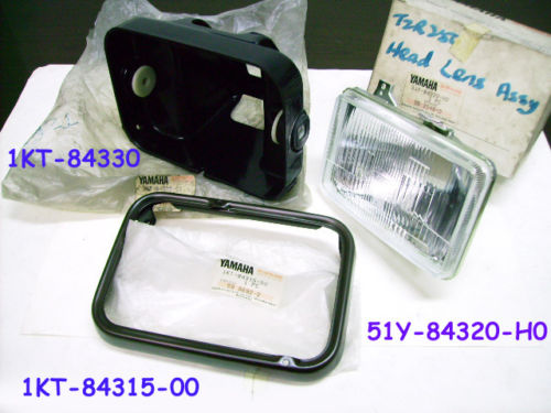

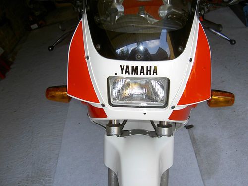

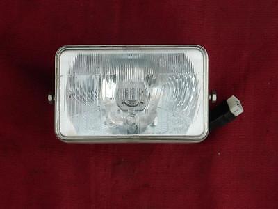

it seems the Yamaha KOITO unit (which was also used on some older XT600 apparently) has similar dimensions. The remaining question is how it can be adapted.
The headlight adjuster screws are in the metal frame. One is positioned in the top left and the other on the bottom. You can see the small holes in the fairing.
