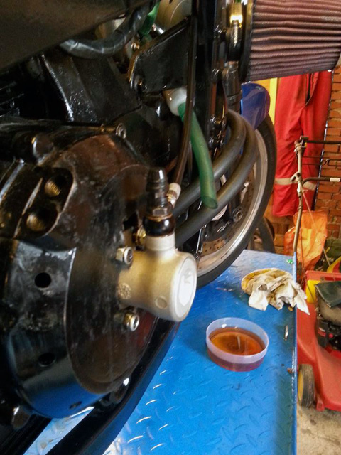

This option was posted on the Paso FB group a while back. Still makes me speechless and I don`t know how that will work with the fairing but I guess it`s one way of fixing it

That's one way to solve it. I mean, if it works, ok, but... Is there a turbo on that bike too? That big cone air filter looks like party of a turbo set up.paso750 wrote:This option was posted on the Paso FB group a while back. Still makes me speechless and I don`t know how that will work with the fairing but I guess it`s one way of fixing it
