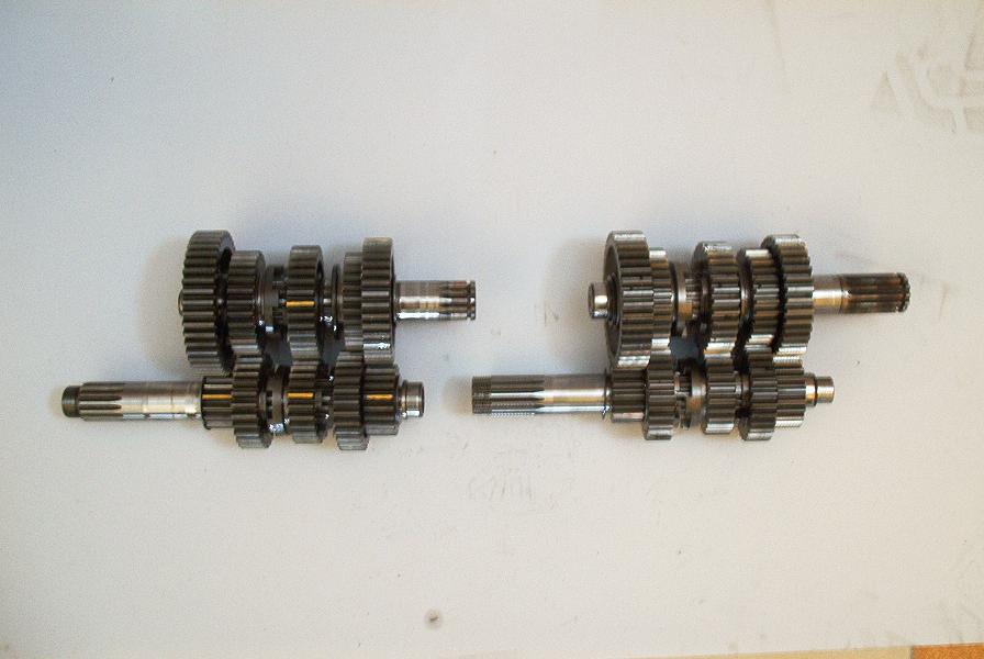

Here you can see some pictures of my gearbox on th left thesre is the original from a Elefant 750 dry clutch, on the right the one from a M600/620
- cambio.JPG (53.84 KiB) Viewed 21432 times

Thanks for the photos , putting the engine together from scratch , so don't have a box at the present , what did you do about the different clutch and the smaller size if the primary side.

The primary shaft of the old pasos is very similar to the new ones the only difference in in the diameter of the nut and the lenght of the shaht were the bearing is fitted.
The pictures I posted are a little bit deceiving as both shafts have the bearing still stuck on them so on the right side (picture) they might look different, when in fact they are the same diameter and the only difference on that side is that the more modern is a little bit longer (can be shortened with a lathe)
