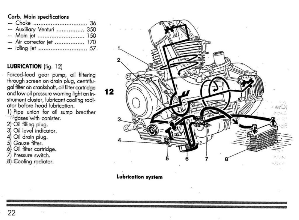

The owners manual is readily available on the site for download, it has all the basic info you'll need to most things
https://www.box.com/shared/pbgnkjcxlq
Plus this thread has nearly every other thing you'll need, heaps of technical and other info
http://forums.ducatipaso.org/viewtopic.php?f=1&t=1551
This should get you started
Ducati 750 Sport Sump Plug Location.JPG (124.39 KiB) Viewed 20508 times
for what your doing just think Lefty Loosy - Righty Tighty when undoing or tightening things up, sounds silly but lying on the ground working underneath a bike or car, it is easy to get confused, well me anyway... :truck:
