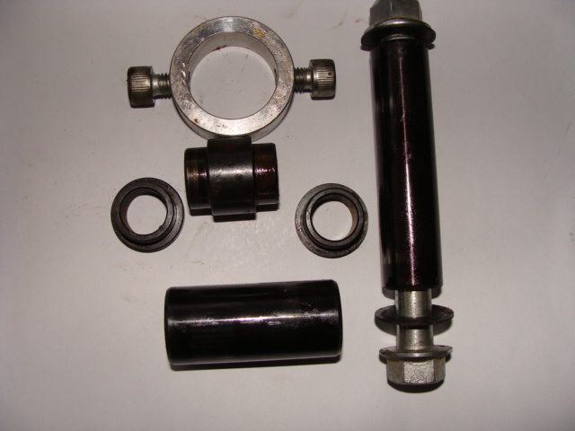

While we are talking swing arms its probly worth taking it out just to get a coat of fresh grease on the pivot bolt ..... assuming it hasn't already seized... and to regrease the bearings in there too
The big bush ( bottom centre ) is the inner race for the needle rollers on the left side , the pivot bolt can seize in this bush , and the one above it (with the two smaller spacers is the spacer assy for the rhs ball bearings which can do the same but not usually as bad.

Well, that makes me feel better, I guess. I was kind of surprised that either the previous owner - who didn't use the bike all that much -Frank.61 wrote:To be honest, Ducati did use helicoils themselves (engine twice).
Possibly they overtorqued them during service (20 nm is not that much for an m10 bolt, also an alu swingarm were the exception in 1988).
might've had it done, or a shop did it without telling me, since I've owned it. Either way, I'm not attempting that fix, so hopefully my favorite shop can make it right for me.
McTool - thanks for the pics & walk-through on the re-grease. That's not a bad idea at all. Mine was still pretty cooperative, but it certainly can't hurt.
