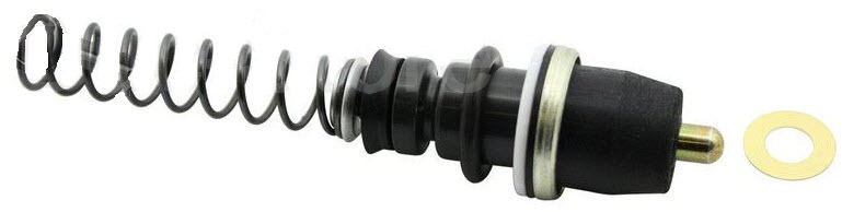

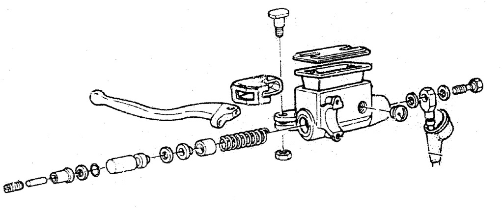

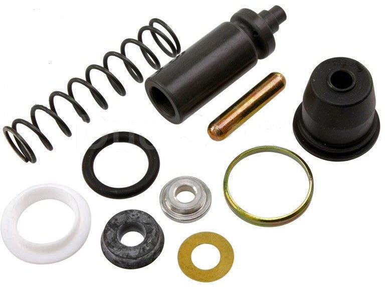

this shows the Ducati #000047226 repair kit and the order it`s installed (looks a little different compared to what the manuals show)

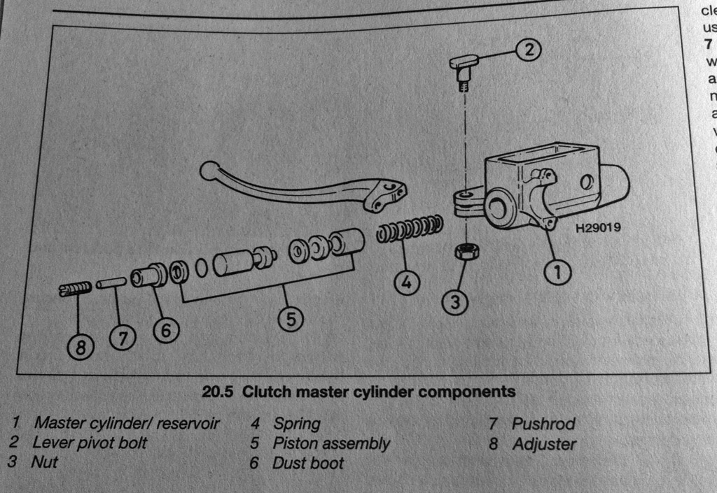

Thanks for all the feedback, it allowed me to complete the rebuild with the Brembo kit without any problems. Unfortunately, it did NOT resolve by problem. After install and filling up with fresh fluid and bleeding appropriately and building proper pressure, the bike still jumped when I shifted into first gear, showing that the clutch was still not engaging when pulled. I'm out of ideas, what could be the issue here, it's not at the master cylinder or clutch lever. Please help!
