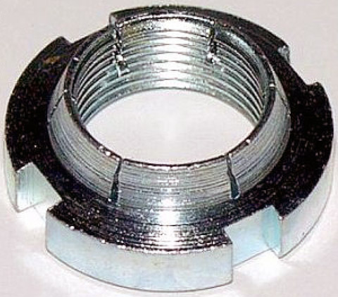

You should be able to get those parts from your local Ducati dealership. Just let them know the part numbers.
Also as you will have to remove the pulleys, I would change those locking nuts with the new type (70350062A). The old type is known to sometimes come loose.
Just saw this, thank you. I will pick up a couple new locking nuts today.
