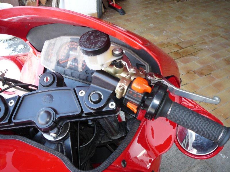

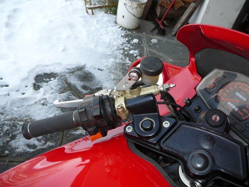

On mine, I had a couple of scares i.e. lever touching the handlebar trying to stop at a traffic light; at the time I though the issue was with the fluid so I replaced it and after bleeding it several times I decided the MCs where crap and replaced them with the Serie Oro from a 916.
Some purists will say "I ruined the bike's Originality", but I believe it is a mod that could have been made at the time of the bike production, therefore... yes, it is not original, but is not out of place.
With the serie oro the bike brakes as it should, looks nice and feels very nice.
Of course I also replaced the calipers, Serie oro all the way.

They look to be the same as the ones on my old SS. I don't think that originality is lost if the mods can be reversed , its not like you had to cut off the old caliper mounts and weld new one on

Yep, this is exactly what I would like to fit to the 907.angelix wrote:On mine, I had a couple of scares i.e. lever touching the handlebar trying to stop at a traffic light; at the time I though the issue was with the fluid so I replaced it and after bleeding it several times I decided the MCs where crap and replaced them with the Serie Oro from a 916.
Some would say you may have ruined the bikes originality, but when you are planted in the front of someone's bonnet 'cause you couldn't stop doesn't do a whole lot for originality either!
The hunt for a set of M/C's is now on.
Cheers.
Nick.
