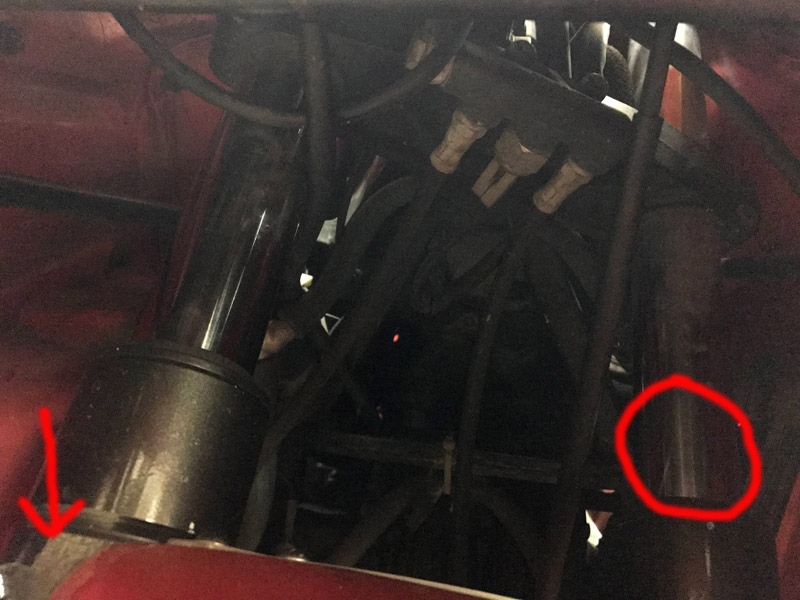

Now, the reason you're all here: (High res: https://imgur.com/a/KXwAF

The bike looks very original. Since the exhaust cans have the small exit diameter it is a US model in which case it will also have the smaller diameter header. (imo the left silencer seems to be repainted) The US model also had the reflectors on the fork. The Euro taillight may have been an upgrade from a past owner. Not sure if the wires in the tool compartment belong to it. However the cable ties indicate that something was done. The vented clutch cover is an aftermarket part.
The regulator/rectifier is still original which isn’t necessarily a good thing however there’s nothing showing signs of overheating. The black rubber ring on the forks rebound adjuster is a rarity btw. That’s often lost.
You should be able to see from the front if that Paso still has the original Weber and airbox. It does look that way.
The tires specially the front one still has the rubber hair but since production stopped over a decade ago those are old and need to be replaced. The handling will improve with new tires. Btw have the tire pressure checked before your test ride.
The only two things I noticed in the pictures is that the paint seems to be scratched off on the right fork leg and the vertical lines on the left fork leg which are probably reflections not scratches. I assume that spots higher up are just dust not any surface rust.
