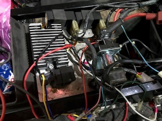

reg
reg
reg rec2.jpg (32.56 KiB) Viewed 25149 times
sorry about the CAPS, The after market reg is ok for the input from the generator usual two yellow and one red,
regulator / rec I have bought has two yellows two reds and black and white, black is case earthed and white prob' + output but means I have extra red mmmm?
tried to add a photo ? not sure it worked, man I'm rubbish at this .

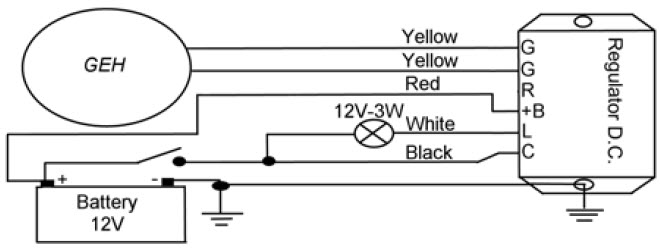

there's contradicting information about the black wire if you search online. :banghead:
Here it says it is actually a ground connection:
http://www.tosave.com/p/Motorcycle-Volt ... 11247.html
Is that black wire as thick as the others or thinner and do you have an ohm meter?

If the black wire reads continuity to the regulator case it is almost definitely a ground wire. Connecting it to a switched 12V circuit will blow a fuse or burn something out.

I Derek that's what I was thinking, getting straight 0.0 ohms from case to black wire so direct connection, have had bike turning over, but not got the old carb back on yet so no real power out genny yet.

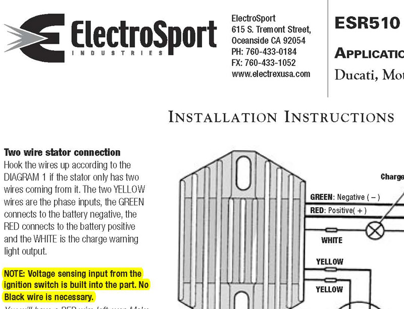

Derek, it seems you're right. But if you look at other regulators tho the black is the sensor wire i.e. Electrex ESR540 or an original Ducati Energia regulator (pic below).
Also in the Electrex ESR510 instruction the black wire is mentioned.
Some regulators have a black ground wire, on others the ground wire is green.

Careful. Let's put it like this. Usually on vehicle electrics black wires are ground, on some regulators tho (i.e. Electrex) ground is not black but green (see pic above). Let's also differ between regulator wiring and the bikes wiring harness. On your P750 the green/black wire is hot. It's the voltage sensor of the original regulator and is connected to the center fuse.
If you measure continuity between the black wire and the housing connect that wire to ground as you already did and isolate the green/black wire from the original wiring. As on the Electrex unit it's not used.
White is for the charge light.
