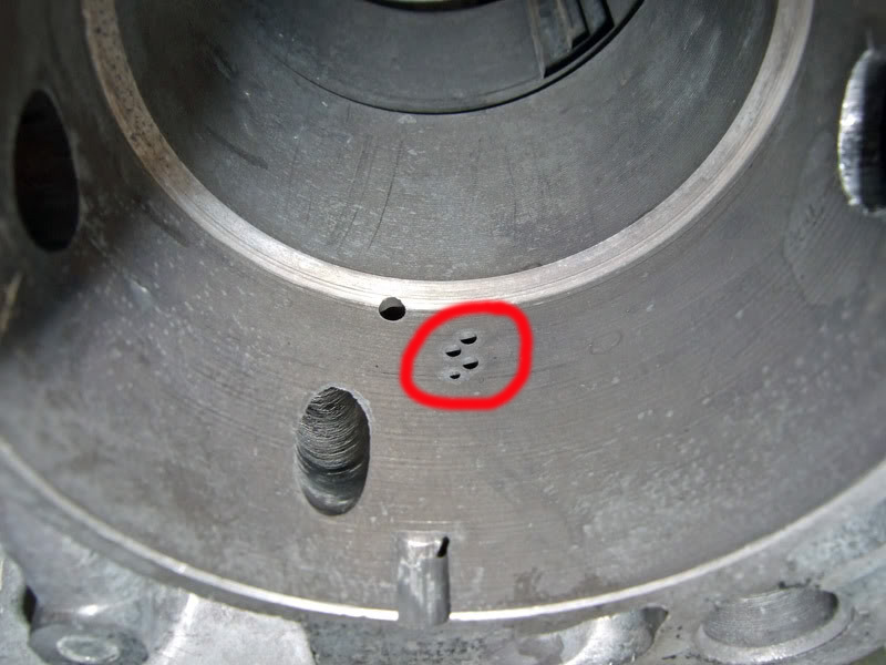

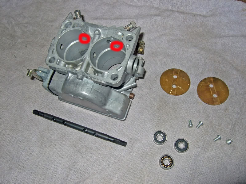

The question came up recently (again) what the differences are. I personally doubt it's just the jetting. Instead I think the difference could be the number and size of the progression holes. To see the progression holes you'll have to turn the Weber upside down and open the throttle valve. The pictures below show a 44DCNF 110. It would be great if you have one of the other models and could post a picture for comparison. I will post this in three forums although I don't like double posts. When I get some replys all info will be joined into one topic and the other two will be deleted.

- DSCF1649.jpg (223.6 KiB) Viewed 10689 times
- DSCF1676.jpg (136.1 KiB) Viewed 10689 times

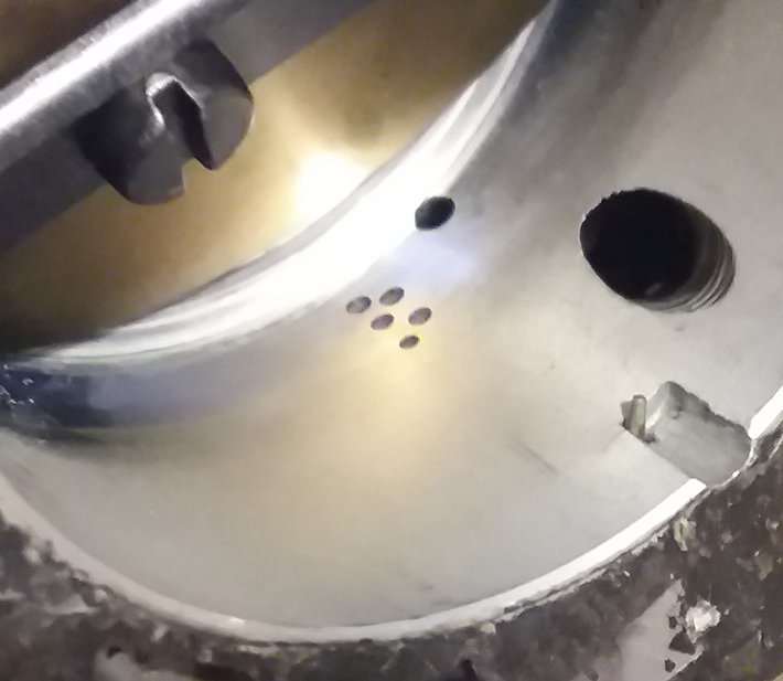

Here the progression holes pic from the 44 dcnf 112.
This one has 5 holes.

Frank, thank you so much for the picture!!!
I'm now guessing the 107 only has 3 progression holes.

PS: Is that next to the point of the adjuster screw a crack?

Best wishes, just looked at my 44 DCNF 107 and it has 4 progression holes

Yeh,, it's a small crack, previous owner will have over torqued the adjuster screws.
Not a big deal, just for synchronizing.

Gerhard,
I will try to measure the holes in the near future (will use the rear of small calibrated drill bits).
By the eye the lowest one is always smaller than the rest.
But I will check it for the 107 & 112.
