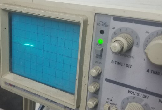

I got some somewhat visible scope shots of the waveforms coming off of the tach and timing sensors. I hope they are attached. They were taken with no load.
It appears both sensors on the bike are the same part. They ohmed the same. I checked that the timing and tach sensors were plugged into the right pins on the ECU. The timing sensor was ~5X greater in magnitude than the tacho. Both were adjusted for the shortest pickup distance the adjustments would allow.
I tried swapping the pickups, and the low amplitude stayed with the tach position. If the low tach amplitude is the problem... Maybe the ECU kills ignition and fuel when it loses tach signal? Kinda weird. I could see the timing sensor doing that... but the tach? Also I don't really see how the steel on the rotor could de-mag, or the spacing could change (larger gap)... which is the only way that amplitude would drop.

- Tachometer Sensor Wave Form
- Tachometer Sensor.jpg (26.58 KiB) Viewed 37358 times
- Timing Sensor Wave Form
- Timing Sensor.jpg (17.68 KiB) Viewed 37358 times

I'm fairly sure that the ECU needs the tach signal to fire as well as the timing signal. A further test on these is; does the fuel pump relay energise when the engine is cranking?
The sensors are inductive, like a guitar pick up. They have a magnet inside them with a coil wound round it. When a steel or iron object is moved near to it it creates a voltage while it's magnetic field is being disturbed. The mass of the metal object (teeth on the flywheel) might have some effect on the size of the pulses.
I can see no other reason why the sensors should give a lower output in the tacho position unless something is pulling it down. I would have thought possibly a failure in the ECU but swapping it made no difference. What about the wiring? Is there any corrosion or oxidation at the connectors or a contaminant allowing a leakage path to earth?

I was going through some old pictures and realized I never posted the solve for this one.
Turns out the tach sensor needed a spacer to increase the signal. the low amplitude trace was due to the sensor being too close. Someone had removed the sensor and failed to replace the spacer...
