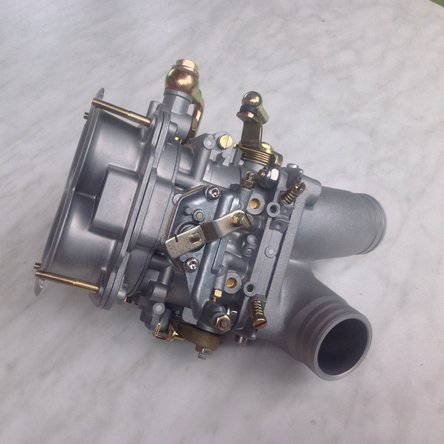

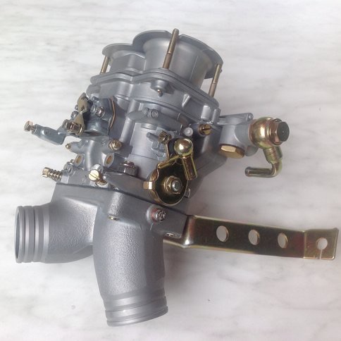

- 0182.jpg (181.89 KiB) Viewed 8358 times
