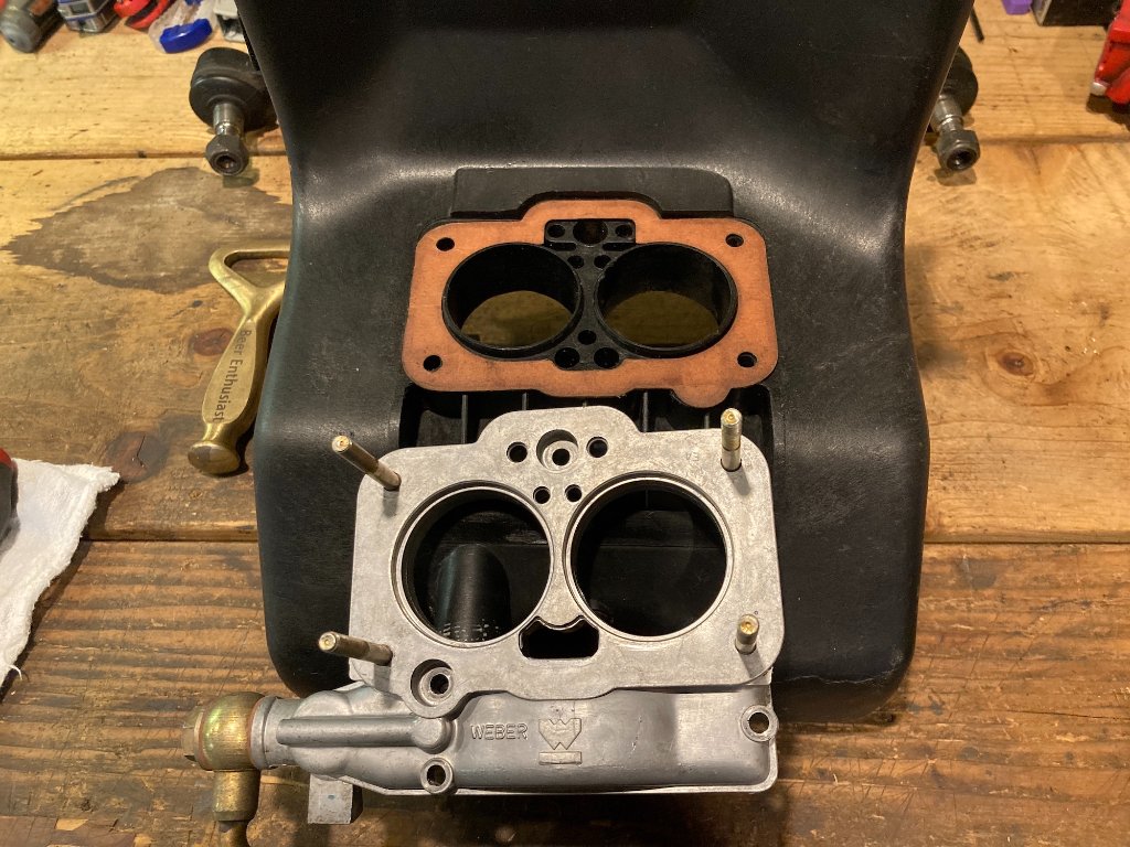

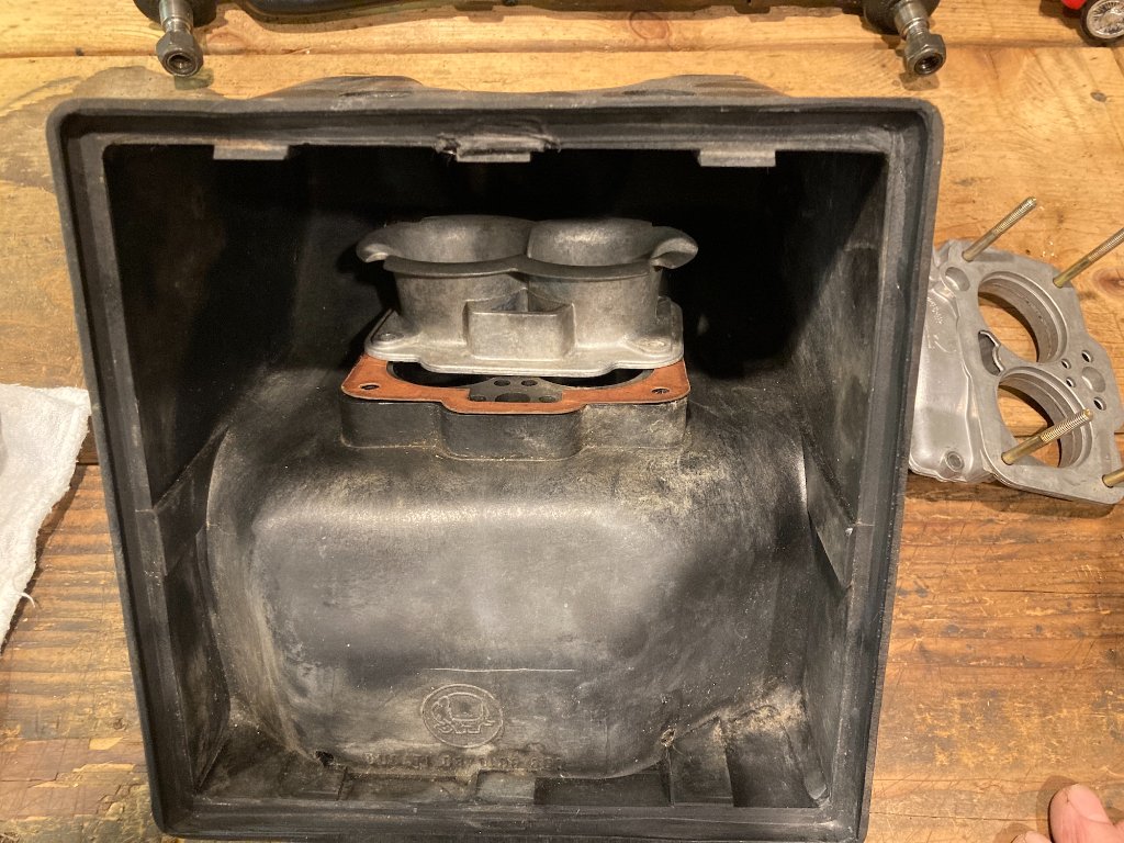

I'm back to trying to fit the Weber on my Paso, and a tear-down has uncovered a few possible issues including incomplete cleaning, and the throttle shaft is bent. Looking at how the airbox mounts to the carburetor, it's unclear to me where the gasket for the airbox is supposed to sit. Is it supposed to be between the airbox and the top of the carburetor, or inside the airbox between the top of the airbox and the air horn? Neither spot actually makes much sense, as the gasket only seals the periphery of whichever two pieces it's between. I hadn't mounted the airbox when I initially tried running the Weber, and realize now that the airbox is specifically drilled/molded to segregate the chokes from the air correctors jets and starter jets. I hadn't realized the importance of this until reading a post by jayh (http://www.forums.ducatipaso.org/viewto ... 5&start=15). Without the airbox mounted the air corrector jets are potentially under a vacuum from the choke (throttle bore) air intake. Based on that, the gasket seems irrelevant and even unwanted in either position, and it seems clear the airbox needs to be mounted for proper running and any running adjustments.

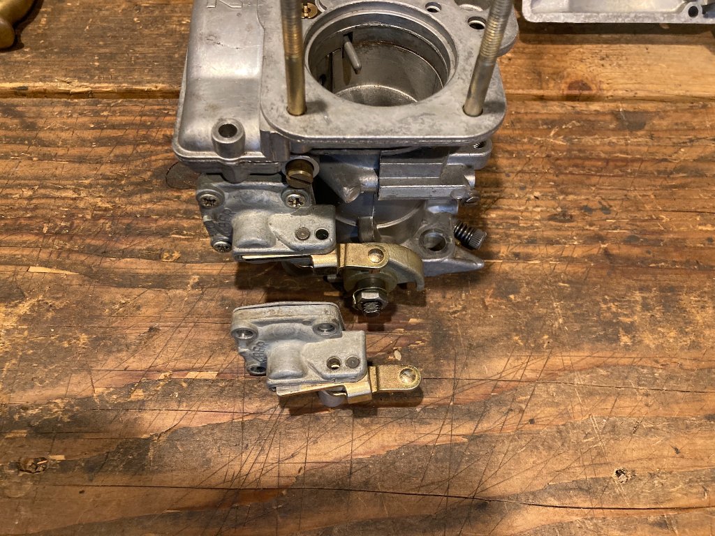

Further, I ended up with two 44 DCMF carbs. The original has damage from the fuel/air screws being turned in so tight they actually deformed/blew out the interior wall of the throttle bores. The used unit I picked up appears to be identical, save for sealed air-bypass screws (I'm assuming it was fitted to either a later or California emissions bike? It was easy to remove the adjustment locks), and the pivot point for the accelerator pump lever is different. The carb that came with the bike has the pivot in location 1, or closer to the accelerator pump.. The pivot in the used carb is in position 2, farther away from the accelerator pump. Does the point of pivot matter in operation? For a given turn of the throttle shaft position 2 would give a longer stroke/more gas.

The gasket is positioned between the Weber and airbox as can be seen in the parts catalog.
The screws of the throttle plates are normally peened so they won't come loose. I'm guessing that this was done w/o placing something underneath as a support. Hence the bent throttle shaft.

The different pivot position changes the lever length. It is as you have explained. Longer lever, more stroke, more fuel.

Yes, the parts catalog does indeed show that, which I somehow missed, thanks. And yes, both Webers have the same numbers stamped on the float: 44 DCNF 110 7H. As to the accelerator pump lever, I'm just curious if one position is better than the other. I would think more stroke would be better, but ...

If the pivot point of the accelerator pump arm is in a different position there might be other differences. Did you compare all the jets? 110 is the number of both the US and California version Weber. However the jetting is not the same and the Cali version has a 36mm choke venturi while it's a 34 in the US version. It might be that the accelerator pump with the longer stroke is from a Weber with a leaner jetting. More stroke isn't better. On hard acceleration too much fuel will cause a hesitation (as will too little).

Weber #2 is from an unknown bike. It had F44 emulsion tubes but had the same air jets, main jets, idle jets, auxiliary venturis and 34mm chokes as #1. Other differences were the accelerator pump arm pin in position 2, giving a shorter stroke, and air bypass screws with anti-tamper caps.
