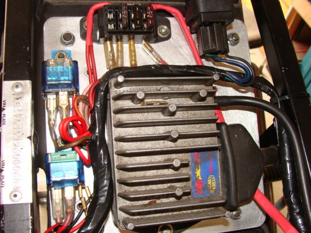

sounds like a grounding issue to me , but it could also be caused by a poor connection in the power supply leading to low voltage . Paso;s are rotten with them . The easiest way is to learn about testing for low voltage or voltage drop ( over a connection ).
I fitted 1 relay for each .... ignition coils and magic box , power supply ( shown in pic ) and one each for hi and low beam ( up by headlight assy )

Mc tool wrote: Wed Jun 29, 2022 5:53 am sounds like a grounding issue to me , but it could also be caused by a poor connection in the power supply leading to low voltage . Paso;s are rotten with them . The easiest way is to learn about testing for low voltage or voltage drop ( over a connection ).
Thanks Mc tool! I'll go in the same direction :cool:
