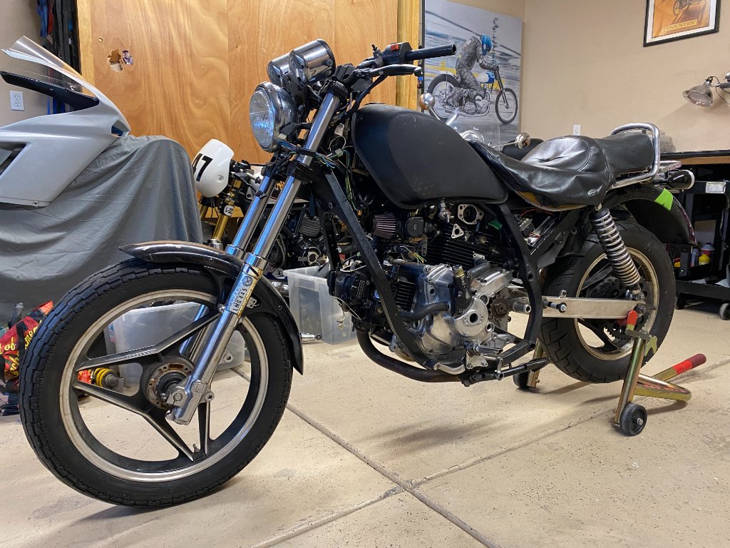

Hello all. I am in search of a known good set of throttle bodies for a 907ie. I am fitting a 907ie motor and electronics into an Indiana chassis. I had a good set, but I used them on a customer's 907ie. His bike had 80k miles and was beginning to have running issues and I diagnosed it by trying my set. That was years ago, and now I am finally back around to this project. I still have the bad set, it looks like the bore of the shaft for the butterfly is just worn out. I had an Indiana in boxes (minus the motor) and a very crashed 907ie frame that still had the motor, harness, and electronics. I decided to save both bikes from the dumpster to make one vile catastrophe of a motorcycle. Anyways, eventually I am going to need a nice set. If anyone has a spare set they'd like to sell and ship, I would like to talk about it. I am in Albuquerque, NM.

Why not convert it to carbs? That would simplify things.

The throttle bodies fit pretty nicely with some pod filters, and ive already mounted the ECU under the passenger seat. Would be more complicated to go with carburetors I think. Would still need the ECU for the ignition even without EFI. The more complicated matter is finding a small radiator with the proper routing of pipes. I am going to move all the coolant sensors to a block style bolted to the front head like a 996. That simplifies it a little, but I still have to make and weld mounting tabs for the radiator and determine a position that will work and clear the steering. I've already split these cases and machined on the swingarm pivot hole for the difference in diameter of swingarm pivots between the two models. So Im married to it. I will look into the set in the Netherlands. Thanks

If you already found how and where to install the EFI system you're fine. Installing carbs is simpler tho. It doesn't require the large Digiplex ECU, vacuum lines nor numerous sensors. It simplifies the wiring, too. Regarding the electrics all that would be required is installing the two pick-ups and bracket from a carbed engine and replacing the flywheel. Then the Kokusan ignition modules (or an Ignitech module) and different coils would be needed. (3-5 ohms, not 0,5 the 907IE uses).
Don't forget the injection system will need a high pressure fuel pump.
