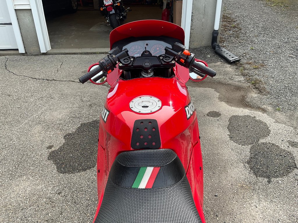

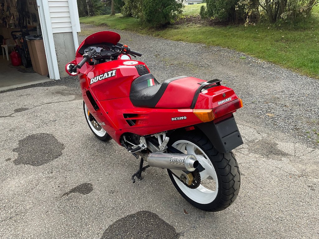

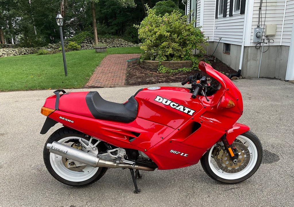

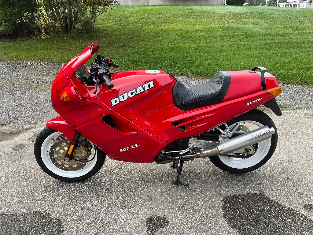

I Recently took in this 907 after sitting for some unknown amount of time. Mileage is 3,7xx
It's amazingly preserved in showroom like condition. Nothing is weathered, stripped, damaged, aged, or discolored. The only age related problem I had getting it running was the fuel hoses inside the tank were dried, cracked, and otherwise looked like a irrigation system at watering time when turning on the key.
It seems to have the original dry rotted front tire based on the 1991 date code
and a replacement rear, in good condition but too old to run based on the 1994 date code.
New Belts from CA Cycleworks
in tank fuel filter and hoses
cleaned the clogged injectors
new battery
and it jumped right to life
I thought I'd share it here.
