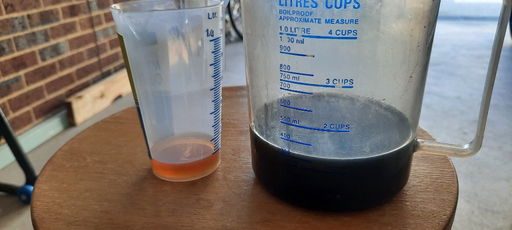

- Drained some excess engine oil out and discovered it's contaminated with petrol (quite a lot). I didn't over fill it upon a recent oil change after all, petrol contamination is the issue.
- Upon going through the carb, I noticed a lot of wetness between the fibre gaskets and I suspect they're leaking down the manifold. Carb was re jetted and these gaskets were changed about 8 years ago so they may be due for a change. Could be something else but thats my first impression.
To do or thoughts?
- Firstly I'm considering a compression test to ensure that side of things is okay.
- If compression is okay, perhaps a full carburretor rebuild? Or new gaskets at a minimum.
Oil pics attached (new vs used). Watery consistency and smells like petrol, has darkened and I've only done about 50kms since the oil change.
To do or thoughts?
