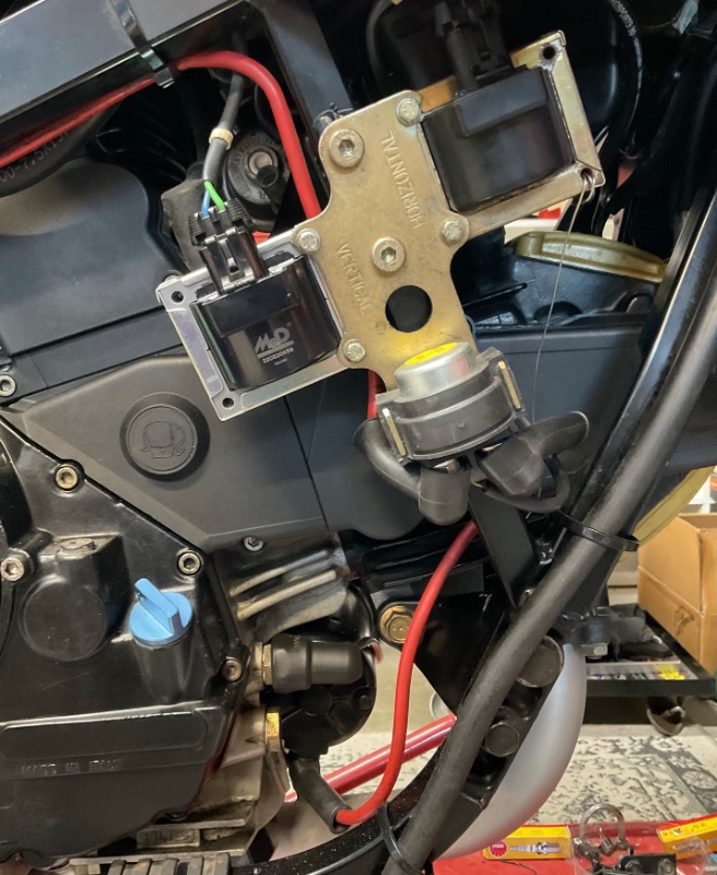

The coils are stock. The horizontal coil from its appearance and markings is the original one. The vertical coil is a replacement that I installed during this troubleshooting process. It is the OE type, mentioned previously being sourced from Gotham Cycles, and the resistance numbers above were for that coil. See the attached pic, it’s on the left.

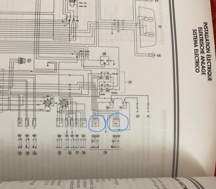

I was looking at the wiring schematic this morning. What are the 2 items labeled “MAE” ? They aren’t mentioned in the legend page.
As a wire from the vertical coil goes to one of them, I want to go down that rabbit hole. What do they physically look like ? Are they also referred to as “power modules” ? Maybe I have a loose connection there.

I tracked down MAE thing, yeah, I think it’s AKA the power module. It is located on the plate holding the V regulator and the relays, sitting below the regulator. I unplugged/reseated each connector going into it, and loosened/tightened the nearby ground. Everything looked ok, nothing suspicious.

The units you refer to are amplifiers for the ignition signals. :beer: :beer:
