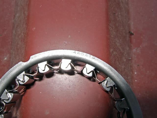

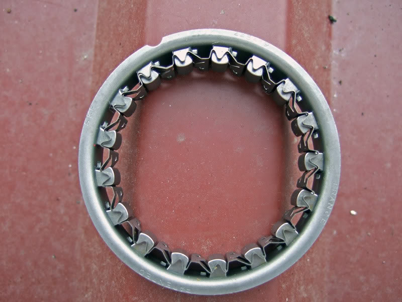

I presssed the starter, and heard a whirling, rattling sound which I figured was a broken starter sprag clutch spring. I figured I would shorten the spring, as has been recommended here. But I found that the sprag in my bike does not have the coil spring running in a channel around the outside of the sprag -instead the outsides of the sprag cams are solid, and there are zig-zag holding springs running around the sides of the cams, on the front and back of the clutch, as can be seen in the photo below. Anyway, I'm off to see suppliers and see if I can find a replacement sprag clutch. I'll start with the local KTM people, to see if I can save on the price of a Ducati one. I can't actually see anything wrong with the unit, and the zig-zag springs look ok, but I'm pretty sure I need to replace it

Dunno if its a trick of light ( or whatever) but that roller ( I know its not really a roller but what else do you call it ?) closest to the camera , just right of centre looks to be worn to me ,on the right hand edge , more so than the others I can see .Which KTM part do you use?( bound to need one some day !)

That sprag clutch looks quite worn to me as well, not only on the single part.
You cannot test it properly by hand, since the acting forces during a real start are much greater than what you can accomplish by hand. I've seen perfect working sprags fail after a head rebuild and new piston rings, where suddenly the bike had full compression again.

I checked my spare. I bought it from a guy who put it up for sale in the forum longer time ago.
He got it here:
http://shop.bevelheaven.com/detail.aspx?ID=67 (214 NZD)
The number on it is SKF 445419.
Strangely I can´t find anything on the internet about it. Maybe a bearing shop can.
