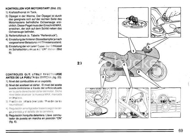

I have a 907. All my mechanics and the shop that rebuilt my engine says oil level between the marks. Below is from the 907 manual.
