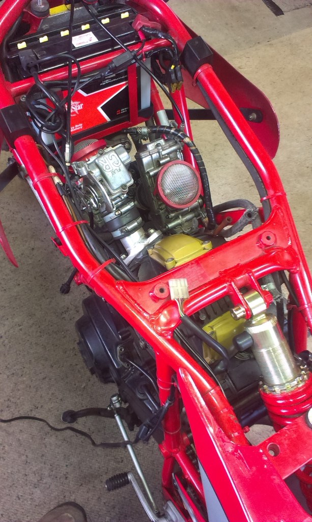

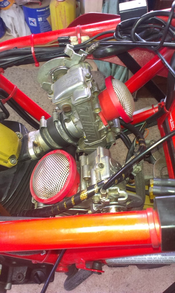

Alternate fitting suggestion
(199.1 KiB) Downloaded 368 times
(182.13 KiB) Downloaded 368 times
(Andrew2 please note RED cable ties :lol: )

:shock: wonderful job you've done there Peter.
Andrew

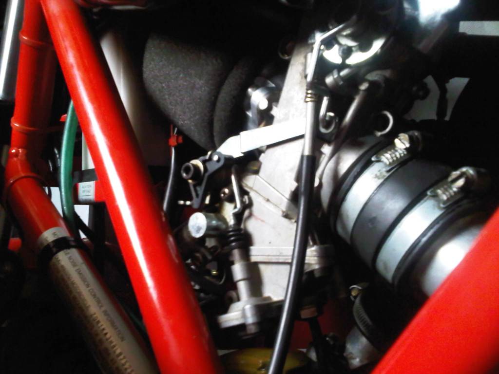

For me there is a noticeable difference between the rock catchers and using foam pod filters which Uni Filter made up a custom set to suit these particular FCR 39's, they require an adaptor to be fitted to attach the Pod Filters too, and were fitted for road use, given my Sport spends most of time doing trackdays, I have it setup as per the photo's originally posted, (getting to the mixture screws is a bastard to say the least regardless)
When it is leaned off for track use you can physically feel the change in the way the power delivery comes on, it literally has more grunt, doing this means engine longevity has big ? against it :shock: , and as I'm a bit mechanically challenged in some area's can't really talk about air/mixture ratio's and all that sort of stuff, I just work and go on feel, when it had the filters on it just didn't go as hard pure and simple, and bear in mind this is a genuine 6,000 Km bike, so barely run in, in Ducati speak. :choo:
When I started the "being nasty to my sport thread" it was not as a joke, that's why they have that funny red line on the tacho, so you know when to change gears :lol: :lol:
Pictures are with the adaptors fitted and the Pod Filters.
Peter
Hey A2 it's an old photo I changed them to Red cable ties :beer:

Re: FCR fitment
If you have a newly painted frame I`d recommend using cloth tape under the cable ties as they can rub on the paint. If you check sports shops that sell i.e. hockey equipment you`ll also find the tape in red ;)
