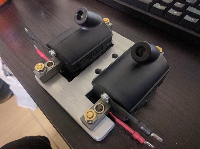

Dynatek DC10-1 coils, Magnecor KV85 wires, new NGK plugs - I did these all at once and had a aluminum bracket made up to fit the dynatek coils, WOW! What a difference, first time starting and I swear before my thumb had reached the bottom it had started and was idling smoothly.

- Coils on bracket with spade connector fitting I made up to keep original harness.
- Coils.jpg (70.65 KiB) Viewed 32573 times

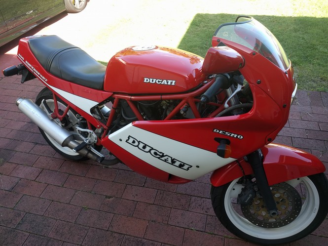

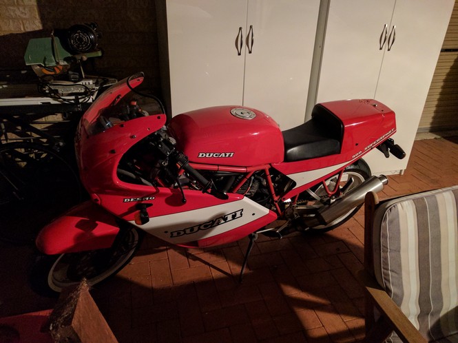

- Single seat cowl fitted and useless mirrors removed.
- As of right now.jpg (74.09 KiB) Viewed 32573 times
- When I first got her home.
- Arrived Home.jpg (93.72 KiB) Viewed 32573 times

No they don't, in the picture of the coils you can see the bracket I had made up to fit them. The coils themselves are much longer. Mine cost me a case of beers through a fabricator I know at work. Any fabrication/machinist shop will have no trouble making a bracket though.do your coils bolt in the original bracket holes
