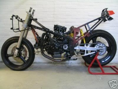

When dealing with the swingarm, Gerhard (Paso750) shows a picture of an early Mosnter swingarm, which uses a huge rocker tucked under the seat, just like the 851/888 bikes. The newer monsters use more of an ST2/4 rear suspension. With either swingarm, you will need to do some serious modifications to them to match up with the stock Paso's suspension linkage and shock. To use a swingarm other than a Paso or 907, you either need to highly modify the swingarm for the Paso's suspension, or you need to graft the other bike's rear suspension to the Paso by highly modifying the frame, and who knows what else.
As Gerhard mentions, I've been working on a modified Paso project. I'm attempting a '99 ST4 916cc engine transplant (with wider swingarm mounting bosses in the cases) with a modified ST2/ST4 swingarm to work with the Paso's stock suspension linkage.
Here is a comparison of an ST2 swingarm with a Paso swingarm...
Here is the modified ST2 swingarm...
Here the swingarm is mounted to the bike...
This is a picture of a Paso with a modified frame to accomodate the suspension from an 851...
