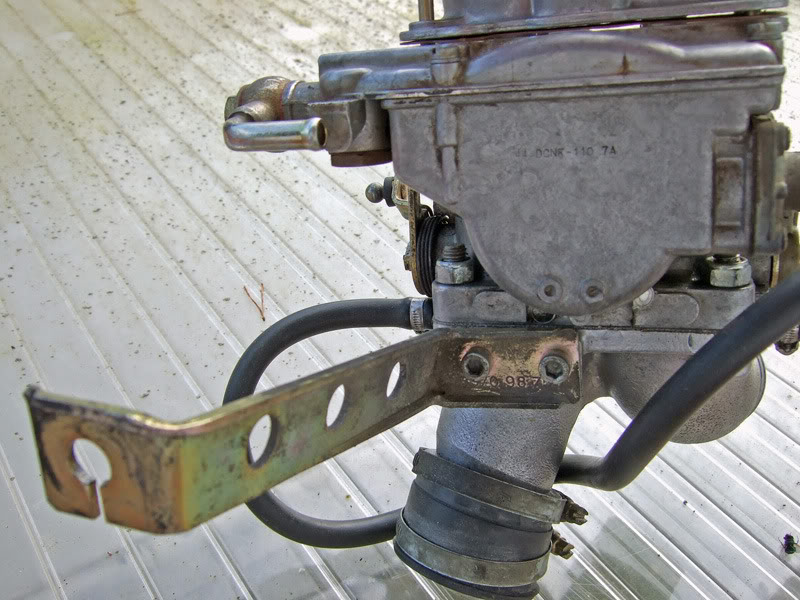

Since I cannot locate a used carb linkage for my Weber, I'm forced to fabricate one if I want to ride my Paso. I need some good close up pics of the linkage extending from the carburator to the throttle cable end. All I have is the cable--and nothing else!
I see the 'ball' connector at the carburetor bellcrank, but there is no 'connection' between the carb and the cable.
HELP!!

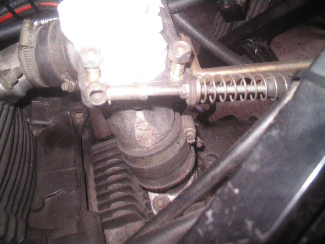

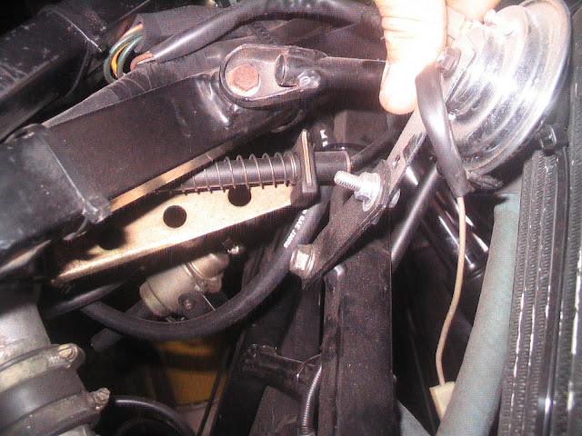

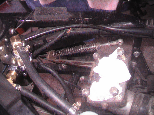

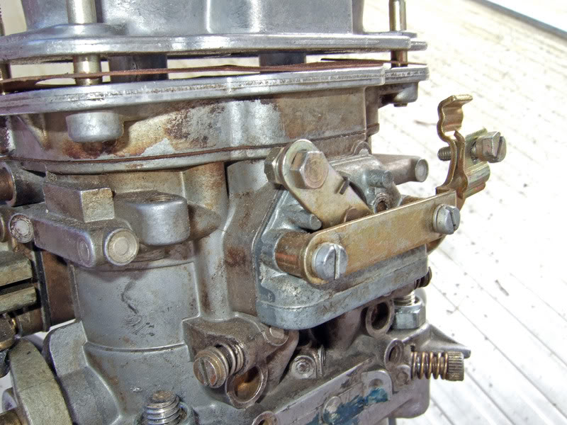

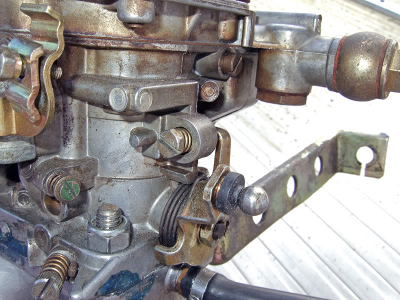

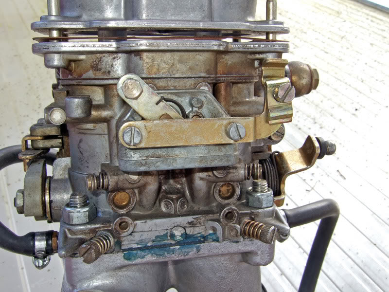

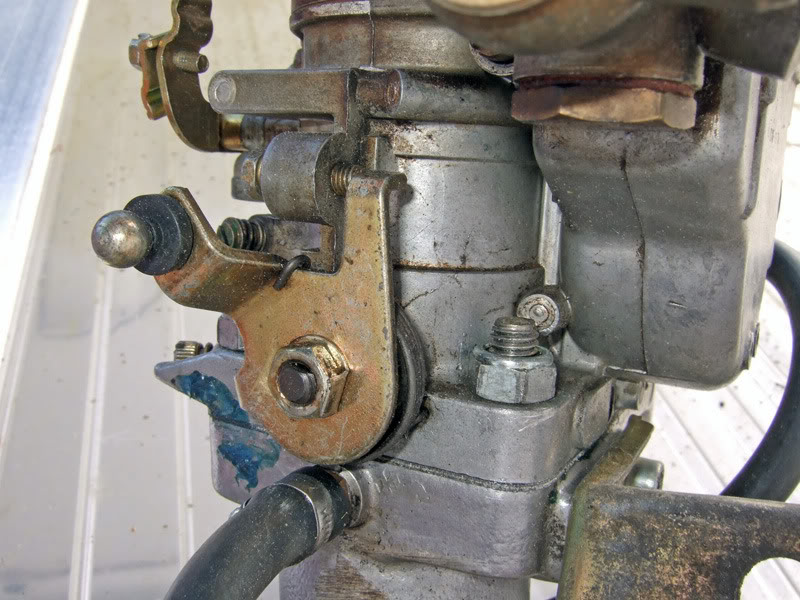

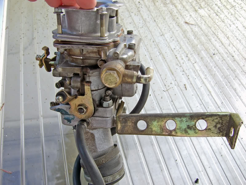

Hope these will help?
This is the end that the cable comes in
if you need some measurements let me know
Rgds Jay.
Rgds Jay.

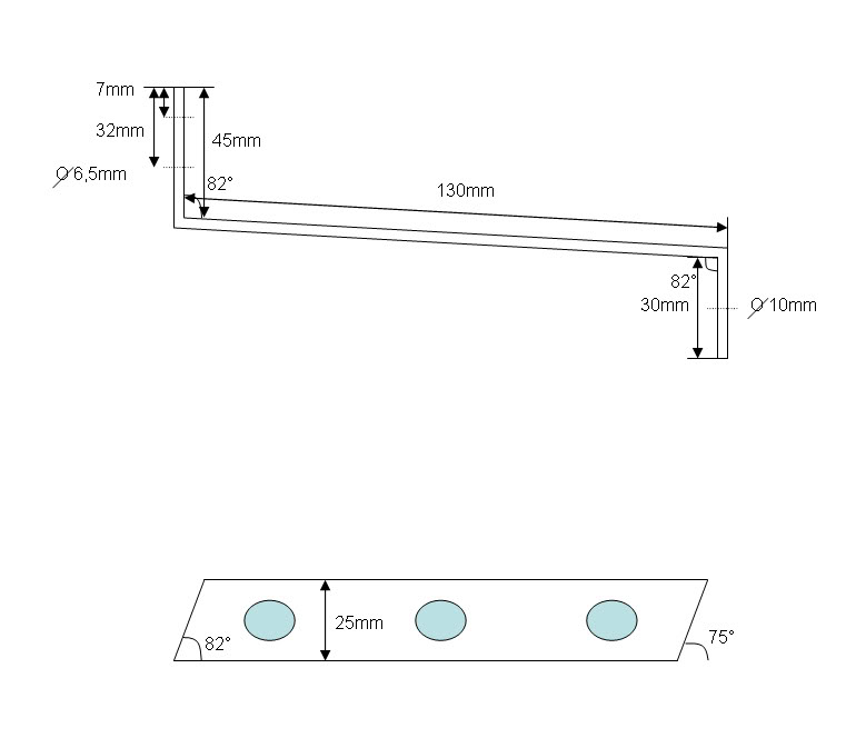

2mm material thickness, edges rolled for better stability.

what is that thing infront of your carb, a fuel pressure regulator ?

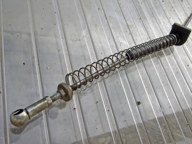

Excellent shots, fellas'! I see that the adjustable rod, spring and black rubber thing are all that I'm missing. If anyone's got them lying around, I will gladly pay...

ell, if you look at the last photo posted by paso750, you will see everything I am missing. My throttle cable is attached to the throttle tube/housing and it moves, but the carb end of the cable just has a metal 'knob', like most throttle cables.
Does the original cable bring the spring, plastic thing and adjusting rod all attached to it?!
I don't think so, but I might be wrong; I think the assembly in the photo that I'm missing is separate from the cable...
Rick

Thats right Paso750 its the holley 12-804 fuel reg mounted upside down,fits in there
just nicely with easy access to mounting screws and a hex key can easily be used from between forks to adjust

Looks like a ball-and-socket design. If you are missing the ball section on your carb, you may be able to substitute a shouldered bolt in it's place. You might need to use a bolt with a bushing to get the correct diameter (and a couple of washers, but I'm sure you can get it to work.paso750 wrote:![]()

Okay, here's the deal: the ONLY thing I am missing from my Paso's throttle cable linkage are the parts in the last photograph provided in the post by paso750. It's the ball socket-threaded rod-coil spring-plastic spacer looking thing. Nothing else.
If this assembly is part of the throttle cable assembly, then, yes, I do need a new throttle cable assembly.
